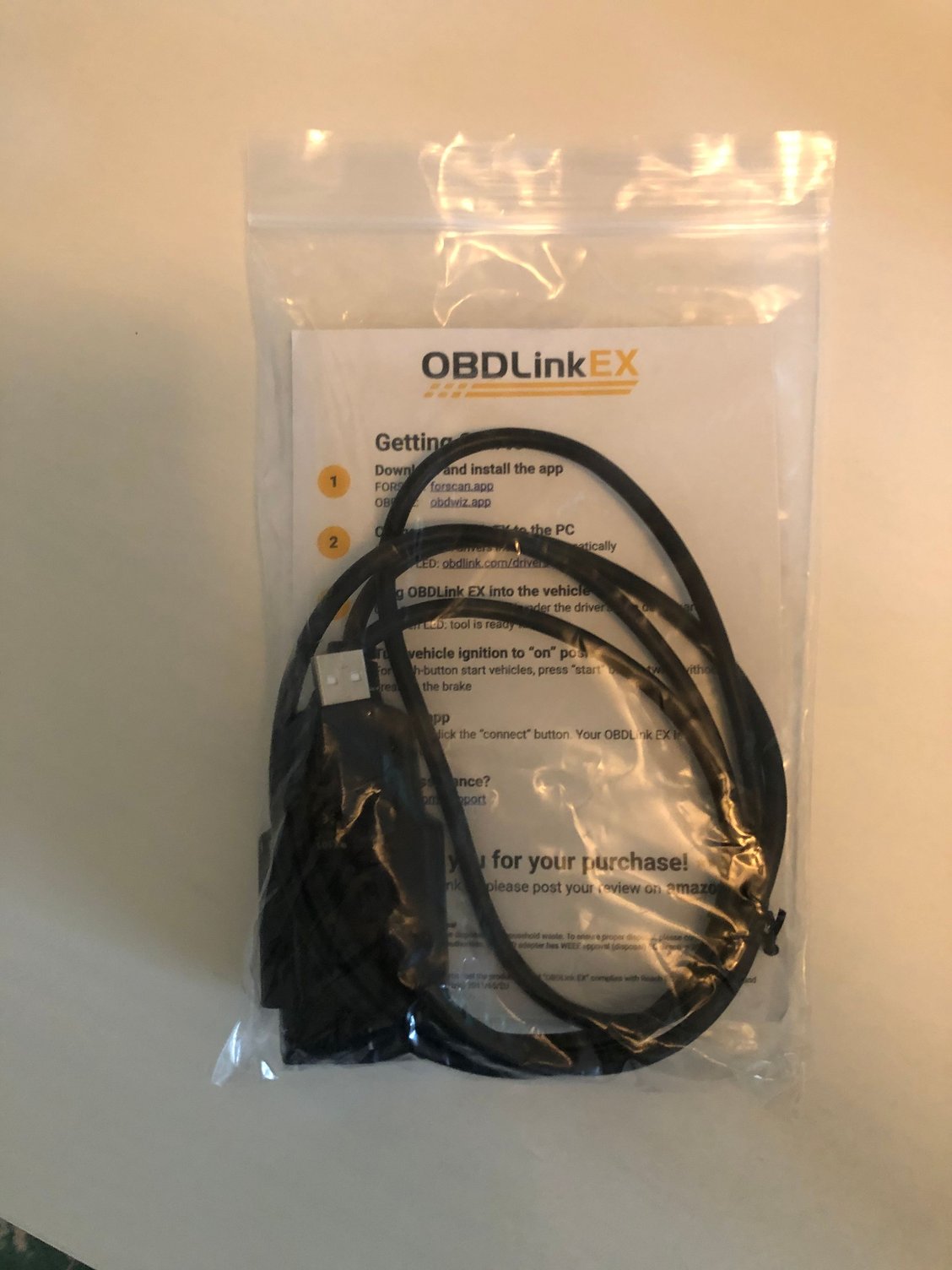

Hey guys! Wanted to report a success using ForScan to add cruise to a car formerly without it.
2013 Mazda3 iSV
Donor buttons from a 2010 Mazda3
Swapped buttons into my wheel because my wheel was a little better condition
ForScan in this case had a toggle for cruise so I didn’t have to mess with the hexadecimal
Highly recommend the program for this and I will be buying a license to support the developers
