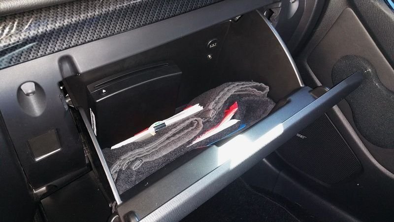

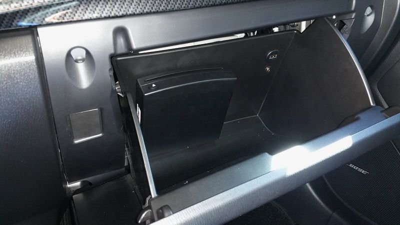

To answer some what you question I know it is easier for some to give alternatives, but I totally understand what you want to do.
The challenge is to tap into the speaker outputs and then use a line out I would recommend the LC2i - AudioControl. Now you can get a simply and inexpensive cd/dvd player and install it in the glove box.
I did this with my 2019 Mazda 3 that came with a factory BOSE system and it works great.
