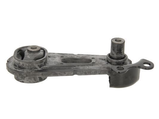

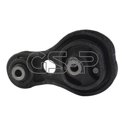

Thank You for advise - 100% need to check it - so far I look for a part - is it the same as "gear box mount" ?
Is it like this one? It says on website Lower.
Or.......... Is it like this one - it says it is........ Rear.

From memory, I think it looks like & also called the "Lower" mount.
