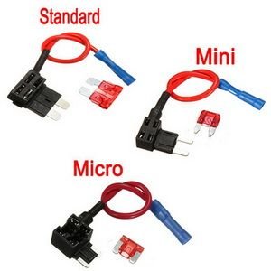

The *12volt ignition active can be any fuse you can install a piggy back with fuse jump connector into the circuit that is active when the ignition is in start position or when the engine has started. You can easily find a fuse that does this with a simple volt/ohm gauge. Check to make sure but most dash cams are 2 or 3 amp a few 5 amp so check fuses that are at least 5 or, 7 or 10 amp powered protected circuit equal or greater then the value for the dash cam.

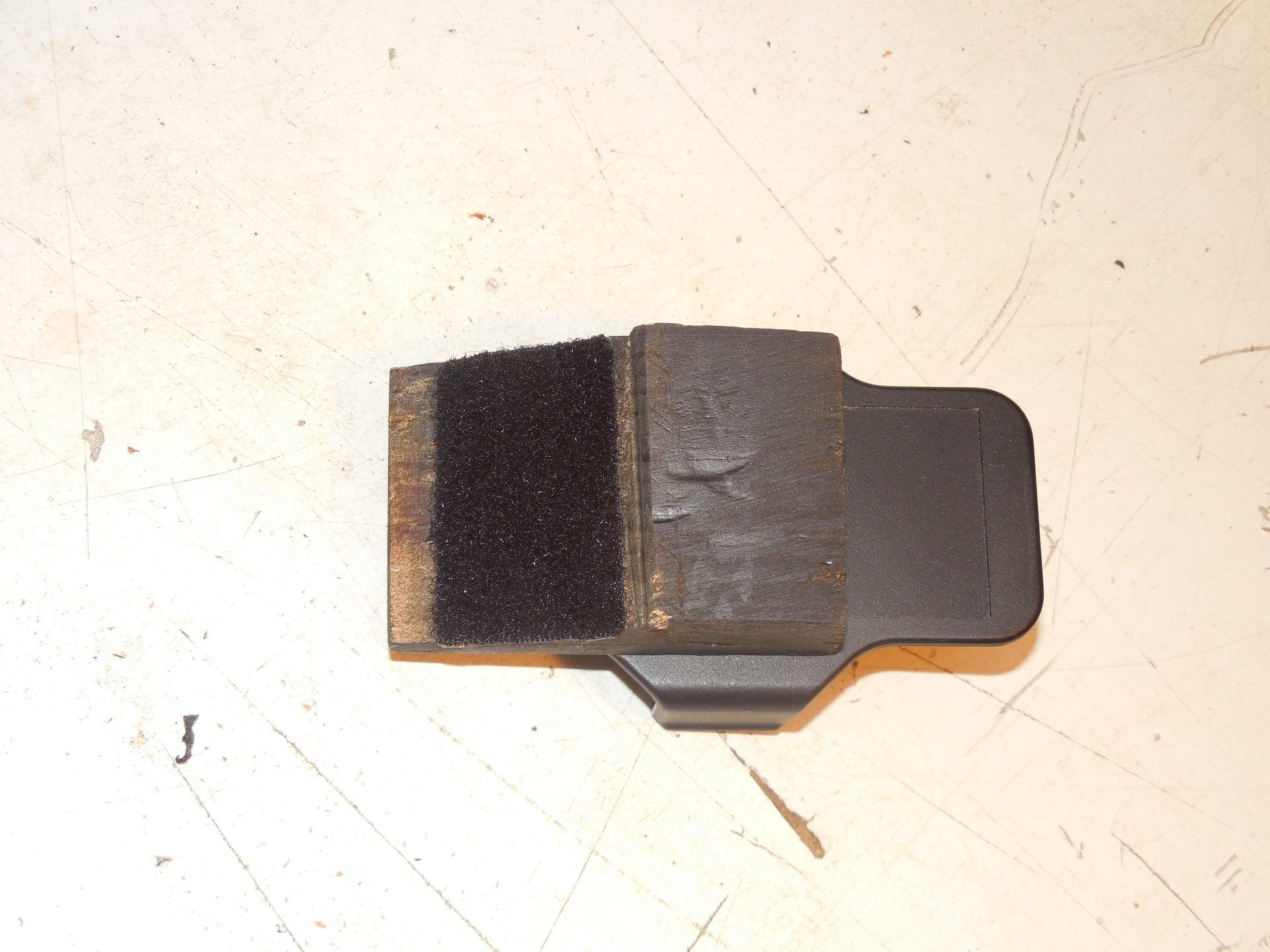

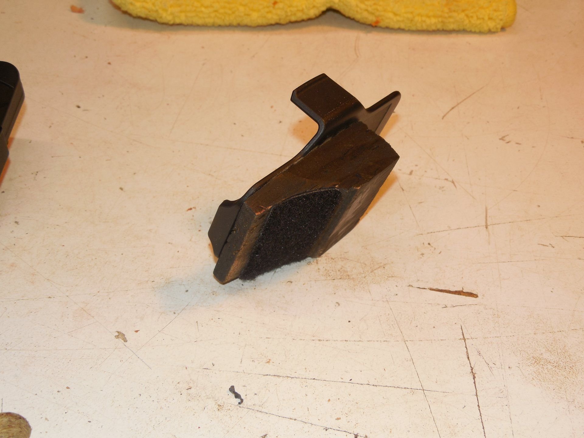

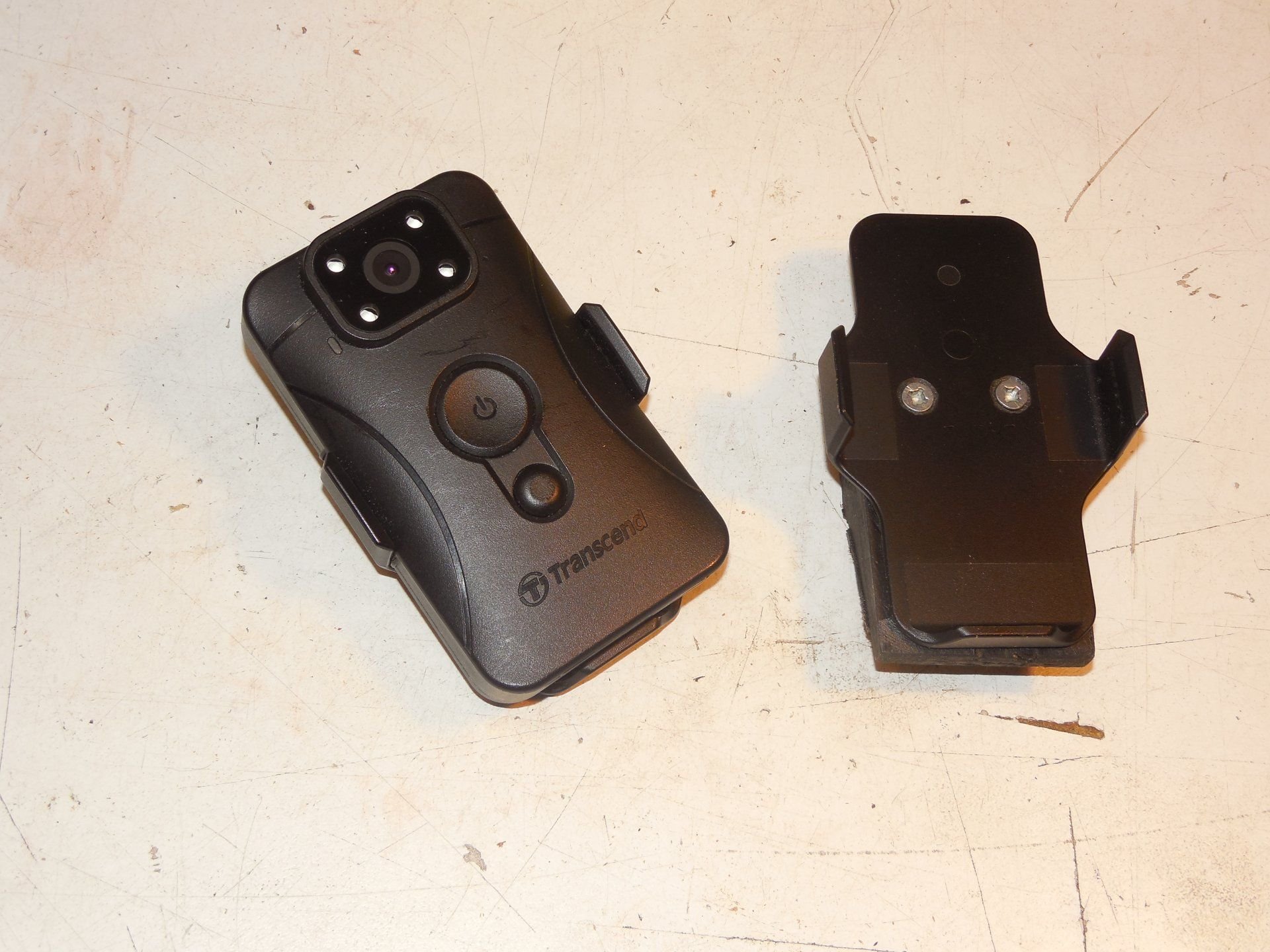

It's almost a necessity to have a dash cam these days for evidence with the way people drive now. My solution was to buy a body cam like the police use. I wear it whenever I walk the dogs for the same reason.
The one I have is HD quality and does color and infrared for night use. It came with two replaceable holders, one with the clip to attach to a coat or belt. The other without the clip which I made a wooden piece which fit the curve of the back of the display monitor. Then I applied "Velcro" to attach the camera. It holds very well and the camera doesn't flop around. The USB cable that came with the body cam will fit a phone charger and I plug that into the DC output jack in the front of the console so I don't run down the battery in the body cam.

if you cannot find a spare slot then use the piggyback fuse and find a fuse that Callisto recommend or what the video suggest.
