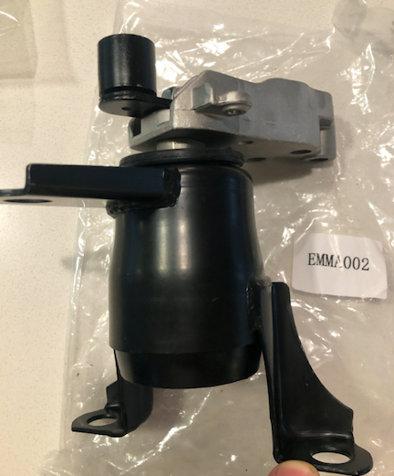

01a NEW TURMAK RHS Top Mount EMMA002
The Top RHS Hybrid Hydraulic Mount is important, the NEW Turmak Unit came fitted with the Aluminium Interface & its "additional Small Damping Unit". With the Engine at Operational Temperature the Top RHS Mount Typically sits at 78Deg C nominal on the Aluminium Arm that bolts to the "Engine Head", the conducted heat results in 51Deg C nominal on the Barrel of the Top Front RHS Mount.
01b Top RHS Mount Aluminium Arm that bolts to the "Engine Head" 78Deg C Nominal
01c Barrel of the Top Front RHS Mount 51Deg C Nominal

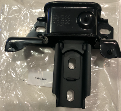

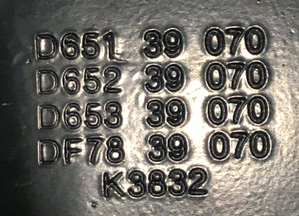

02a NEW TURMAK LHS Transmission Mount EMMA009
02b NEW TURMAK LHS Transmission Mount EMMA009 Compatibility Stampings
02c NEW TURMAK LHS Transmission Mount EMMA009 - New Rubber
02d Old MAZDA Genuine LHS Transmission Mount
02e Old MAZDA Genuine LHS Transmission Mount - Rubber Slight Tear

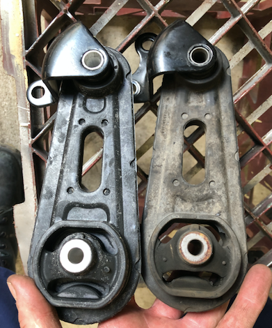

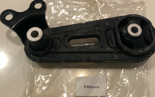

03a NEW TURMAK Rear Engine Mount EMMA010 DG81 39 040 K3832
03b NEW TURMAK Rear Engine Mount EMMA010 DG81 39 040 K3832 Rubber Embossing
03c NEW TURMAK & Old MAZDA Genuine Rear Engine Mount Comparison
03d Old MAZDA Genuine Rear Engine Mount D652 39 040 K3832
03e Old MAZDA Genuine Rear Engine Mount - Rubber Tears
