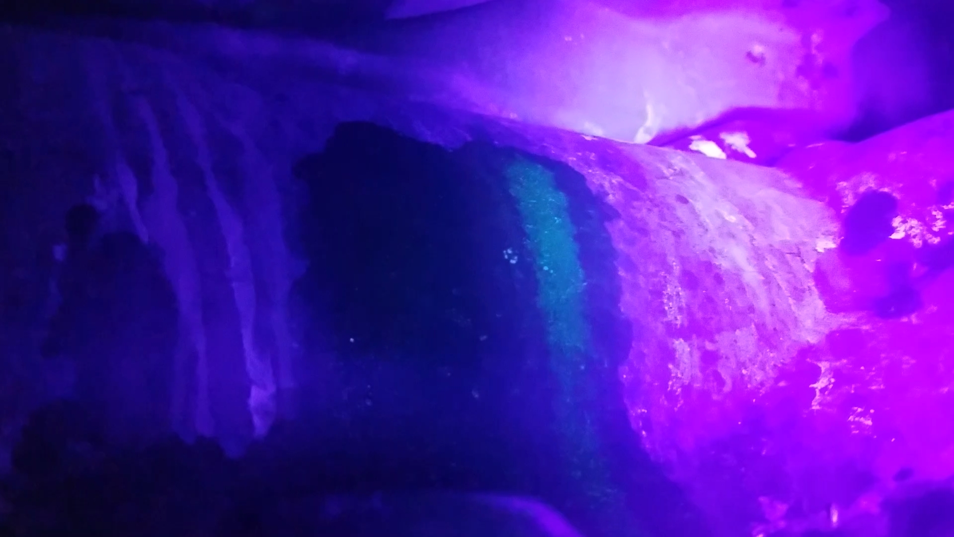

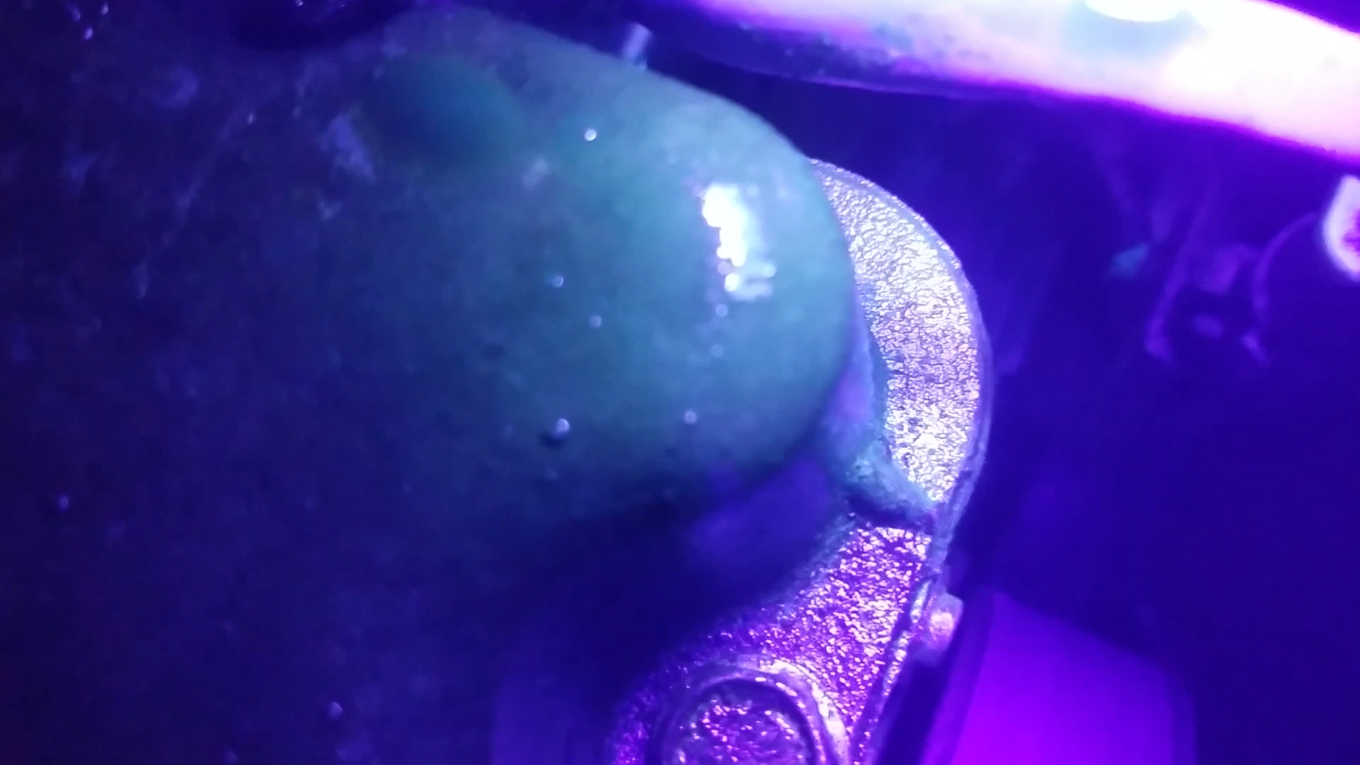

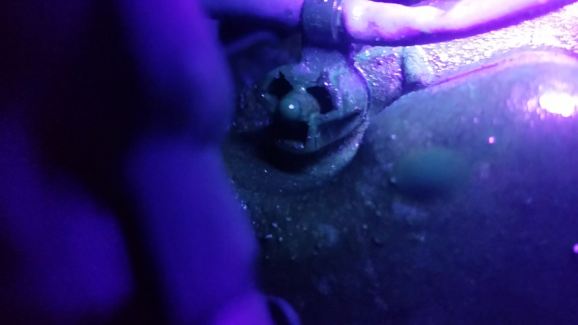

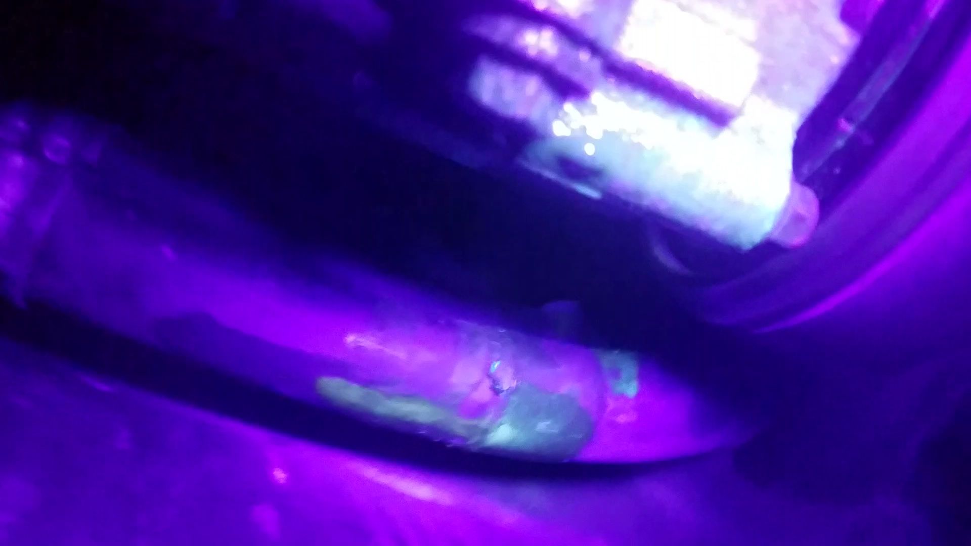

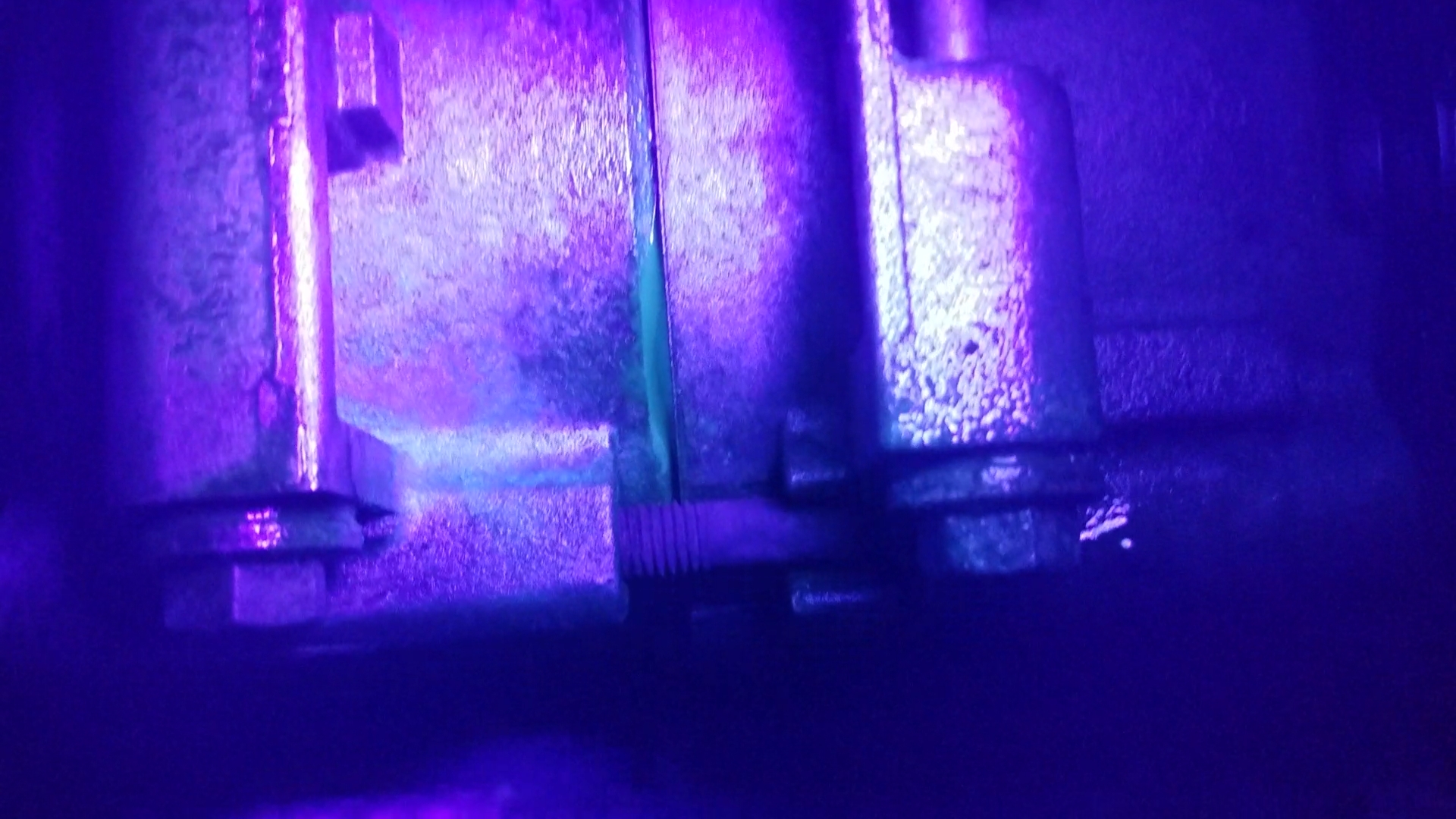

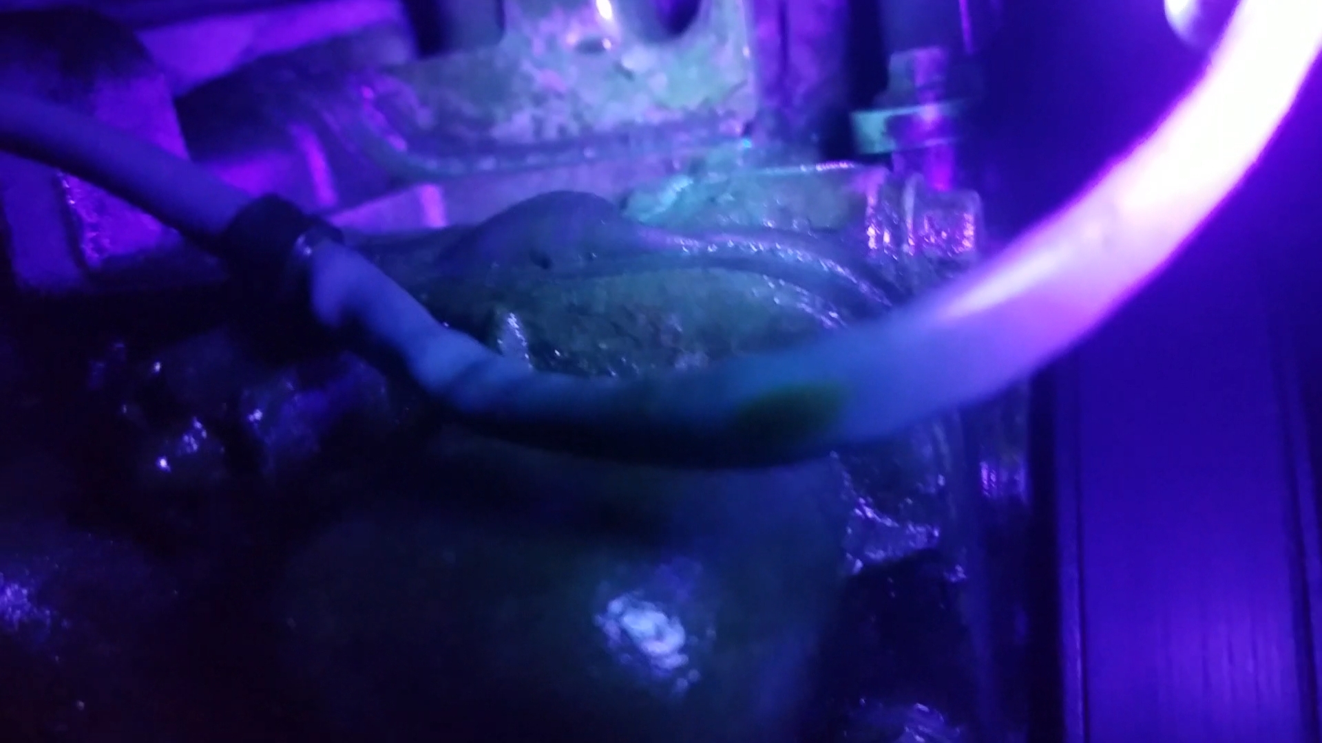

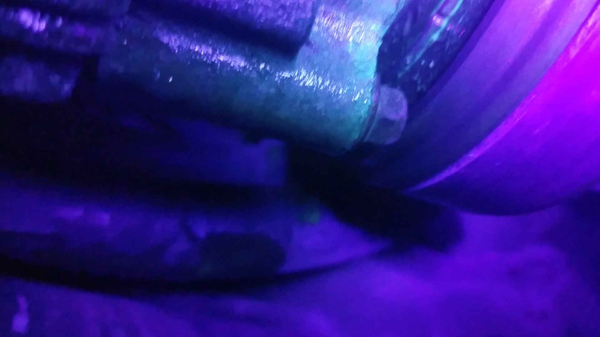

Ok I have an update.and it's pretty weird .. i put some UV dye in the oil and just checked it tonight .. this is after driving about 150 miles. The OIL is Greenish (in the video you will see some other greenish stuff but that's dry and not oil)
I found some oil on the AC Compressor ... and basically in the passenger rear corner of the oil pan. The front seal seemed good, the valve cover seemed good, nothing from the water pump area or the side of the engine above the front seal, and nothing near the oil filter.
Here are some pics .. i do think i might have a slow leak from the rear corner of the oil pan (so i will replace that) however the oil being on the AC Compressor is puzzling to me.
AC Compressor

Hose in front of AC Compressor
Plastic in front of AC Compressor
Rear passenger corner of oil pan 1
Rear passenger corner of oil pan 2
Rear passenger corner of oil pan 3 showing the RTV where i think it slowly seeps out

Old Dec 24, 2019 | 03:29 AM
noel1955's Avatar
Joined: Dec 2019
Posts: 27
From: NSW Australia
I had / have a similar problem with oil on the sump etc. Had many gaskets changed to no avail. I later found the leak coming from the oil cooler which was running down the oil filter them blowing underneath when she was driven. Just a thought.
