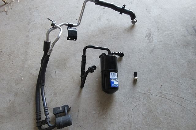

The A/C manifold pipes turned up yesterday from the wreckers , cleaned them up , put on some new foam pipe insulator at one end , got some o-rings and all ready to go , btw new receiver/drier and oil pressure switch shown also , switch was playing up a year ago but came good and since the switch is behind the a/c compressor which is coming off might as well replace it and a new belt .
The original pipes (still on) 1 was leaking at the swage from pipe to hose letting out the gas , a green oily substance could be seen .
some new some from wreckers
