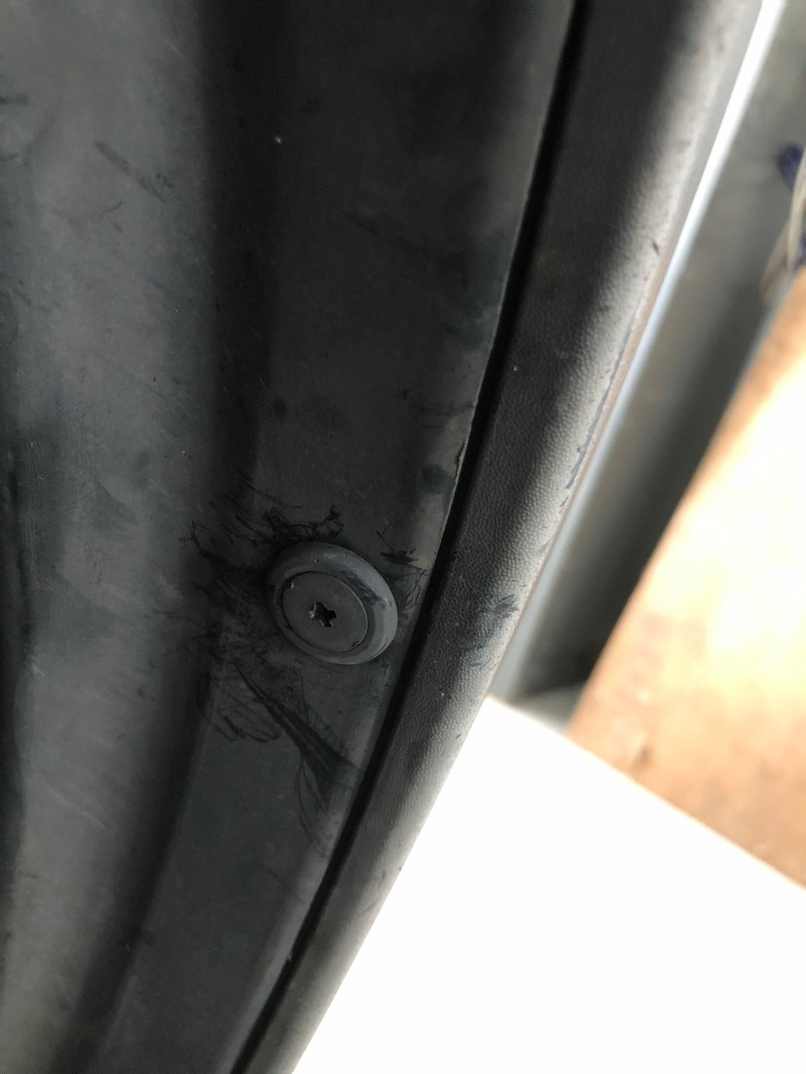

Hi All,
thanks very much, the above info worked well, 2006 Mazda Tribute (2.3L?), front blinker (turn) light.
There are 3 clips and 1 screw to remove.
The bulb comes out by turning anticlockwise (1/8 of a turn).
With the clips, the phillips head is a trick, just use a sharp knife to pull out the inner ring, this releases the clip, and then pry the entire clip off. This way you won't break the clip and they can be reused.
I though it was the bulb, but I tested the bulb on a 12V battery, and it worked well. I cleaned the terminals (where the bulb connects), and it worked again!
Hope this post helps the next person!
Good luck!
