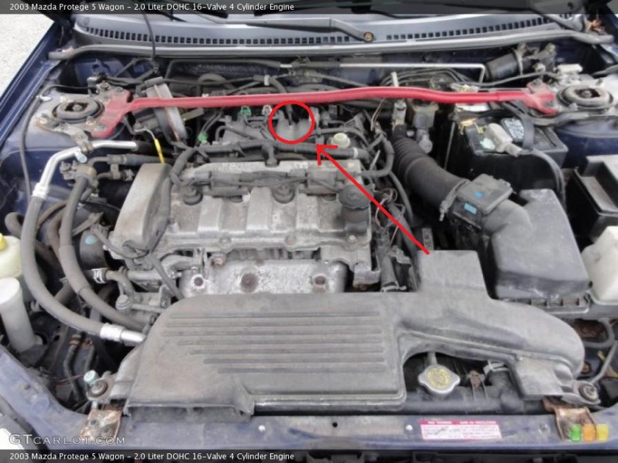

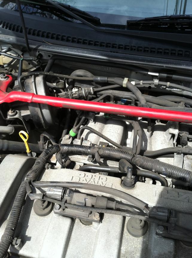

2003 Mazda Protege5. This tube is cut and seams to be leaking air while the engine is on. I can't find an engine bay diagram to find out what this tube is. Any ideas on what it is/does? Would it be okay to just wrap it with tape?

I am not a protégé expert, but that line looks like it's a vaccuum line going to that round item on the left which looks a brake booster. How's your brakes feeling. Wrap it with tape to get somewhere to get the part and put in on when you get there. Phone for part first. Wait for tanprotege to respond he's the protégé expert.
The brakes feel fine. My car was recently towed twice in the last 2 weeks. They replaced the battery and the alternator belt. I opened up my hood and found this tube leaking air. A friend said that this could be the brake booster or the cruise control actuator, neither of which i know anything about. Is this something I can just tape up with electrical tape or send back to the shop?

I would use a lot of tape, drive it there and leave it til fixed. You may want to e-mail them the pic and make sure they get part first, cause it would be easy to change as you wait.

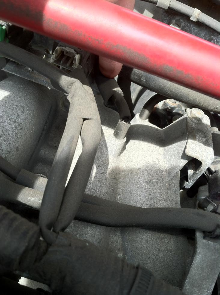

This is where it is cut, its still hanging on by a thread.
And im not sure if this has anything to do with this problem, but my car has an automatic transmission and when the car is parked and idling whatever is underneath the shifter is rumbling. It sounds like everything underneath it is shaking rapidly. no problems while driving though.

Snakkup: go to a auto parts store and get a length of this tubing for a couple of bucks. Put it in and it's fixed.
That shaky idle will be better as well.

Thanks, this did the trick. But as for the shaking underneath the shifter... Whenever im on my brake, or using something electrical like if my lights are on, toggling the window switches, or anything like that... the rumbling stops. But when I let go it continues. I just recently got my battery and alternator belt replaced. Could this be the alternator?

Indirectly it is the alternator. It tells me the alternator is good. When you use an electrical devise the alternator kicks in to deliver the juice, powered by the idling engine. The idle speed controller keeps keeps the engine from dying. It raises the idle speed and that calms down the engine vibrations.
Make sure the battery cables are properly attached. Make sure the grounding wires and straps are attached with good clean contact areas. Make sure the cables on the alternator are properly attached.
Treat the engine as if it had rough idle concerns. Run a good fuel system cleaner through the tank.
It's 10 years old: give it new spark plugs and wires (if it has wires).
Just basic tune up stuff. Wait for Noggin to take over he is the basic tune up expert. That includes replacing the pcv!
