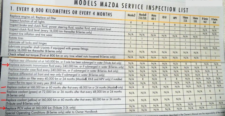

Not changing the PCV valve could lead to damaged pre-cat as well. A faulty PCV valve could send extra amounts of oil back in to engine causing carbon deposits and clogging of the pre-catalytic converter. Unfortunately, checking or changing the PCV valve is not on Mazda's service schedule for most Mazdas (see pic in attachments: N/A means Not Applicable --- really, who are you kidding Mazda) and i would recommend it changed every 2 years after the first 3-4 years.
Another item that should not be overlooked is the EGR valve. When stuck open it will send excess carbon amounts as well.
Changing the automatic transmission is another pet peeve of mine and is not on Mazda Service Schedule. (see pic in attachments: N/A means Not Applicable --- really, who are you kidding Mazda).
This should be done every 30,000 miles especially if a flush is involved.
I would also strongly suggest an external tranny cooler.

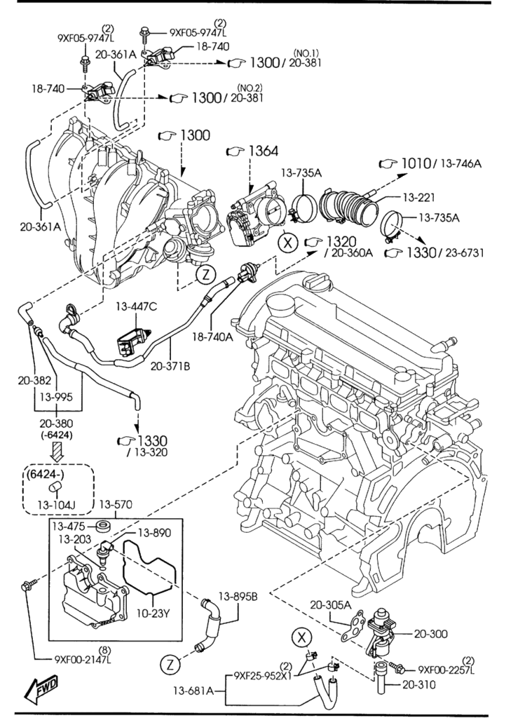

I know you have the 4 cylinder! Thanks for asking.
I remember in the older days, PCV valves were changed quite frequently like 1-2 times a year. Due to car manufacturers wanting to promote less maintenance, this has been omitted!
Pic below shows it on 4 cylinder below the yellow clip. Quote from someone: I had the dealer replace the PCV valve, it cost me $410. Number 13-890 in the bottom left, part number L325-13-890A, good for 04-08 model year 6i's, while ONLY the 03 6i uses part number L305-13-890. The cost from the dealer should be roughly $12. Looks like a lot of fun to service, being underneath the intake manifold. Ought to just do the VTCS removal when you service this, just for the hell of it.
