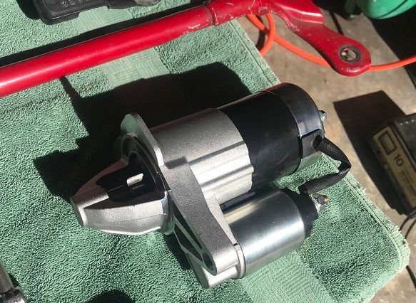

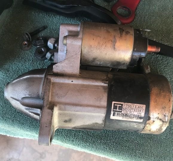

Once out, compared it to the new one (always make sure they match). Looks good. Got my battery charger out to test the old starter. When I jumped the solenoid, it did extend the drive and spin up. Repeated this several times and each time it spun. However, I did hear a bit of bearing whine and other "rumbling" from it. Did the same to the new one and it spun up much faster, with greater torque and less noise.

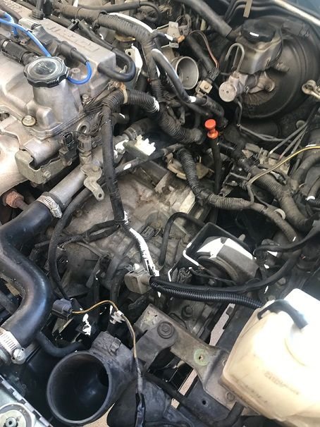

OK, so the installation is the reverse of removal, right? Well, no yoga position, sacred swear words or offering of blood would allow the new starter to slip into place. I couldn't seem to get the right angle since I was on my back with the car up on jack stands. One part that was in the way was a bracket from under the intake manifold. Once I took it out, the starter slipped right in. I must have missed that part of the video.
Well, once the starter was in place, it was pretty straightforward from here. Some of the clips that support the various harnesses were already broken and there was a bolt missing from the battery tray. Perhaps signs of previous work. So, a few zip ties and spare 6x1.0 bolt and we're done.

Old Starter
New Starter
Engine bay prepared
