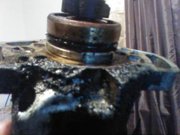

here are a few pics of what i got

Looks rather evil doesn't it.
Take the cap and rotor off. There should be a cover below the rotor. Below that cover sits the cam position sensor. Get some electronics cleaner that will completely evaporate and spray it clean. Put it back together with a new O-ring and cross your fingers.

hey i can't get the rotor to come off. is there a specific way i should remove it?

It is just pushed on. Be prepared to replace it. You could try tapping it loose with the handle of a screw driver used as a hammer.
How old is that rotor ?

That's exactly what I was thinking I had to do. I believe it is the stock rotor from the factory because it is a Mitsubishi part and I also noticed that the crankshaft position sensor was a Mitsubishi part too.

There are a lot of Mitsubishi parts throughout the car, mostly sensors and electrical parts. I bet it would be a good thing to replace the cap and rotor anyway. If you agree you can gently chisel the old one off.
