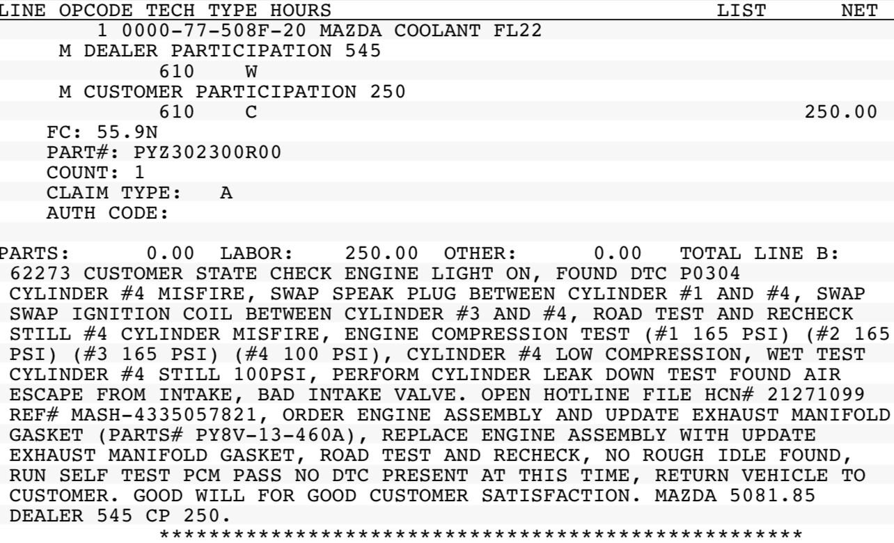

PTguy, you seem very knowledgeable, maybe you can help me understand what’s going on with my car. Brand new 2019 CX-9 sport fully serviced at dealership and on time with all oil changes and maintenance packages (even though I knew I was being overcharged , I didn’t care because of the peace of mind I believed I was buying).
At 62K check engine light comes on (Sep 2021). Dealer states an engine replacement is needed and will do it as “good will” since warranty only covers up to 60k. After 90 days I finally received my vehicle back.
Fast forward 30k miles (Sep 2022) and the check engine light is on again! This time dealer took 30 days for diagnosis and states engine needs to be replaced again, this time on my dime for 9.5K.

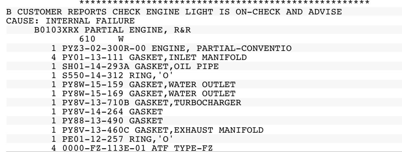

After reading the original invoice for the first engine replacement I noticed something odd. Although the service advisor told me the engine was “fully replaced “ the paperwork documents a partial replacement due to cylinder misfire. All they replaced was a gasket and intake valve, does that count as an engine replacement?? Also, buried in the paperwork is mention of coolant replacement. I’m very disappointed and feel like they’re trying to deceive me. What’s your take? Attached are snippets of the invoice . Thanks in advance for any insight.
The first line of the parts list is "Engine, partial-conventio..." That is the new engine. I don't know what they define as a partial engine, certainly excluding alternator, turbocharger, etc. Anyway, that's the new engine. And a bunch of gaskets, o-rings, and some automatic transmission fluid was lost somewhere in the process so that was replaced. Coolant must be drained when the engine is taken out, so new coolant is filled into the new engine. This much sounds OK.
Another new engine?...Check with Mazda North America, (800) 222-5500. Tell them what has happened. If they too say that another engine is needed, ask them why, and ask them what you should have done differently after the first replacement engine (they won't have an answer). The fault in these engines is Mazda's problem, and they should not try to make it the customer's problem.
