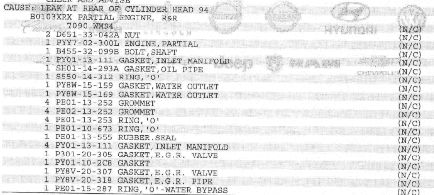

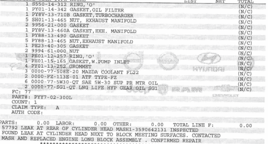

Old Apr 8, 2021 | 01:52 PM
Raoul Paquin's Avatar
From: south Florida
Default just had this happen on my 2017 signature
they put a brand new engine in...
parts list of what they replaced....under warranty
