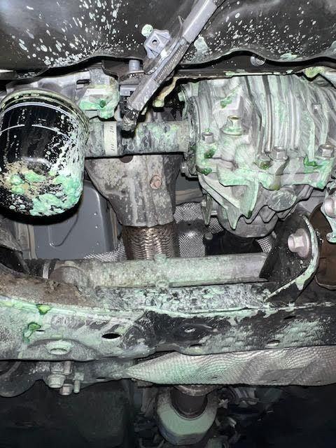

My 2017 CX9 started showing engine was heating up and decided to drop it off at the local Mazda dealer. I am always regular about service maintenance, so when I got the news that the coolant was leaking and I need a possible engine replacement I was shocked. My car has only 57k miles on it and I am seeing other members here experienced similar issue? My warranty also ran out two months ago. I am dreading what they are gonna ask me to pay for a new engine. They are not telling me exactly how it leaked as I had it serviced just a month ago. They said they are waiting for Mazda HQ to report back how to move forward and engine replacement will take a month due to out of stock. It does not make sense why I have to pay for a new engine if this issue seems like a to be happening to most cx-9 owners. What are my options and I am at my wits end! Any advice is appreciated.

These see the pics I got from the service center after requesting for it. They usually do check up and let customer know what’s going on but in this case the service center did not call back the whole day. I got hold of them after calling them several times and they waited till the next day to send it to me after I asked them for it again.
