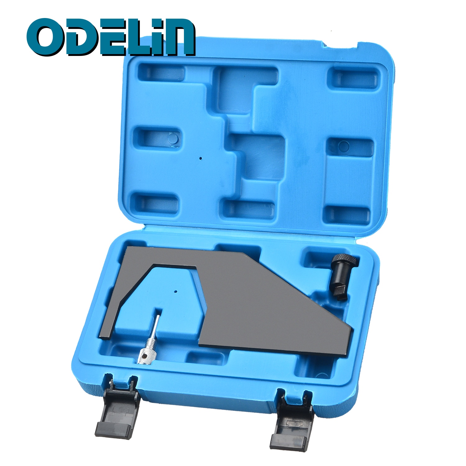

Are you using both the cam locking plate and crank locking pin?

Yes, both when resetting the crank pulley and to rechecking the timing.
