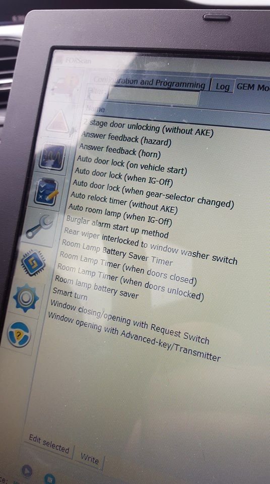

Thought I would add my experience with Forscan on my 2011 2.5 cx-7, Should be about the same from 2010-2012 ( At least in the us) I have no idea if it will work with 07-09 models
I was able to to read the pcm, instrument cluster, gem, restraint module, tcm, and abs,
I was also able to program keys and read many different data pids, There are some bidirectional controls, Pretty dang good for a free program
