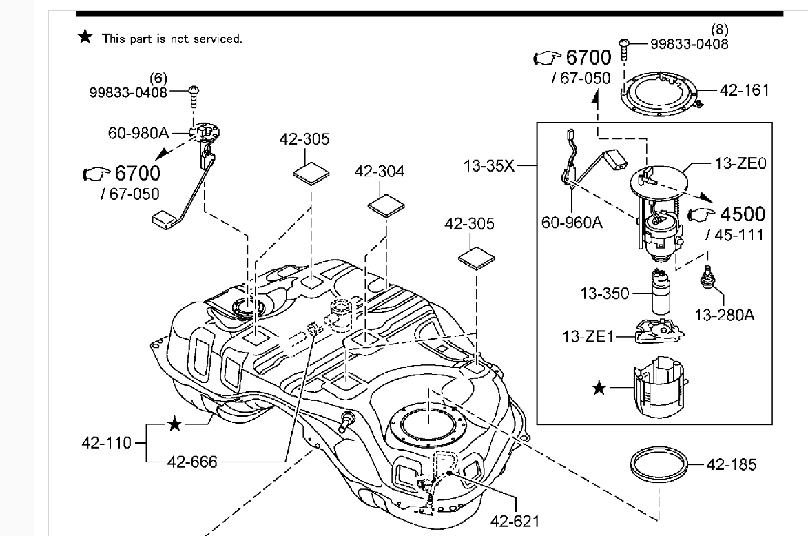

I posted on this thread a couple years ago, and still have no resolution on my wife's 2017 CX-5 which has had this same issue since 40k miles.
I'm pretty sure I know what's causing this though!
I’m guessing you have an AWD CX-5?
I’ve read about a few folks also having the issue, but it doesn’t seem widespread. This actually happened to me again today (with the most fuel so far, 67 miles to empty).
What I believe is happening is: Because of the rear driveshaft, the CX-5 AWD has a “saddle” shaped fuel tank. There are two sumps, with two fuel level senders. The fuel pump is in the driver side sump. There is a “syphon” Venturi in the main fuel pump that sucks the fuel from the passenger side sump.
I think that the syphon system doesn’t work properly sometimes.
The driver sump empties, but there is still a good amount of fuel in the passenger sump. The driver fuel sensor knows it’s empty, but the passenger side sensor still shows a lot of fuel, and the gauge in the dash is the average of the two (aka, ~1/8th tank).
I’ve disassembled the fuel system and haven’t seen any obvious problem. I haven’t started replacing parts yet, but it’s time to dig into it.

That only further indicates that not going below a 1/4 tank of fuel, would indeed, be a simple solution to alleviate the issue of running out of fuel.
Though I would be interested to learn if your siphon theory reaches the stage of a scientific hypothesis.
Please keep us informed, should you find the actual reason why this happens to a relatively small percentage and not the majority.

The average driving mileage of a 2.5L CX-5 is roughly 458 or 114 miles per 1/4 tank.
The physics of how a siphon works would explain his theory but it is still a theory.
The solution would be in the physics, specifically correcting the atmospheric pressure differential which is causing the loss of the siphon effect.
Simple physics shows that can be achieved by altering the hose size, tank volume or combination of both.
Or by the easiest pressure differential solution, which would be adding more fuel. Which translates to not letting the full tank go below 1/4 in the first place.
