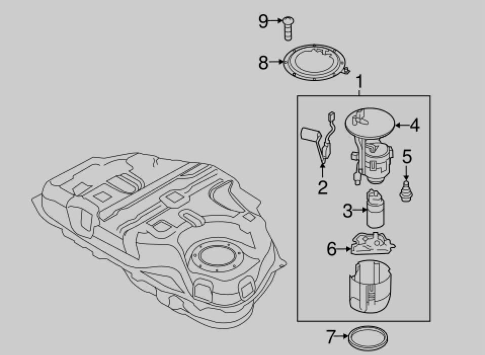

If the OP really wanted to know how his fuel pickup worked he could google it. Here is a diagram of the in-tank fuel pump and filter assembly, and a link to more schematics. The last few gallons of fuel in any tank are usually full of concentrated dirt and water which can plug/damage the high pressure fuel injection system, it is not intended to be sucked into the engine. Perhaps a Mazda isn’t for him.
https://www.realmazdaparts.com/v-201...tem--fuel-pump

There's some chance I'm interpreting things incorrectly, but I don't think so, and am completely open to all hypothesis. Mostly I'm interested to know how fuel is collected from the tank and delivered to the engine, and a poorly detailed schematic doesn't inform my understanding well enough (which again is why I'm on the forum and not easily solving my own problem).
It's a fleet vehicle, so I have little incentive to put my own effort into this, except that I'm curious and like to solve problems. I might pop the fuel pump out and put an inspection camera in the tank to see what's going on... but I'm at 57k miles and it should be under warranty still.
EDIT: A Youtube video shows the fuel pickup tube is attached very low on the fuel pump. Perhaps this has detached and I'm only pulling fuel directly from the pump, and not from the hose that sits lower in the tank. The fuel hose in the tank isn't listed in any parts diagrams I'm finding.
