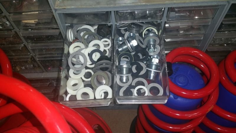

Now on the technical side...yes you should change them every-time you remove the drain plug. All of them made from nylon,fiber,copper,aluminum etc. will crush to some degree and make a unique pattern when the drain plug is tight which insure an oil tight seal leak free seal also resistance on the plug that prevents it from backing out and leaking oil.
Mazda drain plug washer change. new one in my hand .
