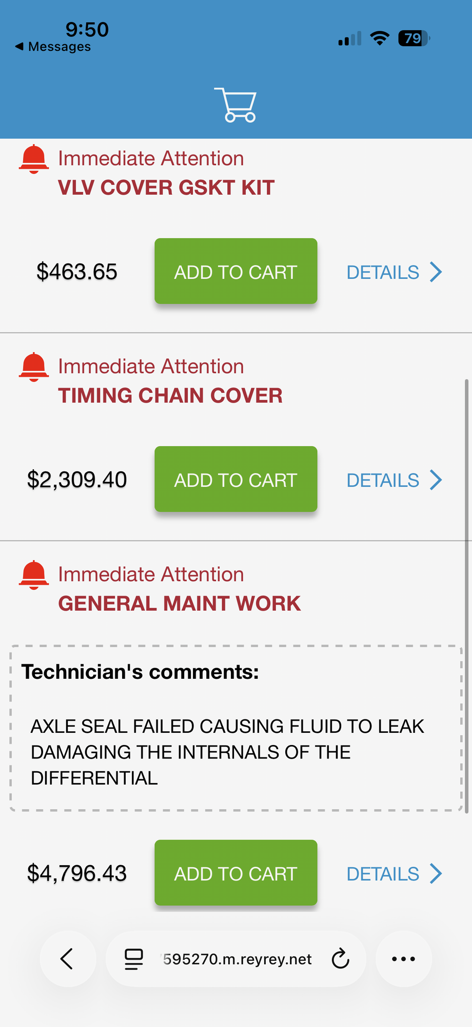

Just a quick update. I spoke to a case manager at Mazda HQ. They're going to have another case manager from the Georgia region reach out to me later this week. From there they will contact the dealership we had the car diagnosed at and confirmed it needed repairs. They told me on the phone that we fulfill a lot of the factors that would make it more likely to get some help/goodwill on the repairs (service work, going to dealerships, having multiple Mazda's, etc). I attached an image showing to quoted prices for the rear diff replacement, timing cover gasket, and valve cover gasket. The timing cover gasket costs so much because they have to pull the entire engine out from the bottom of the frame. Didn't even know it required that much work!
I was also told about something else we could potentially do if we wanted to forgo the repairs. They said we could go another route where they give us a full trade value certificate (even with the bad rear diff and gaskets) for the car that could be redeemed on a new car at a Mazda dealer. From there they would give us a new car at employee pricing, which I'm assuming is like 10% off. If the repairs would cost nearly what it would be to get a new car, we may explore this option.
The quoted work repair for the car.
