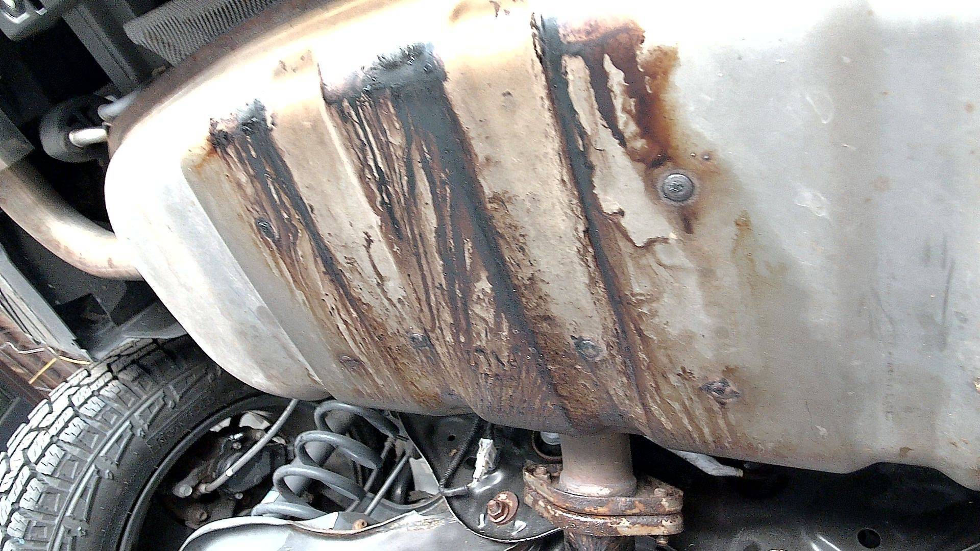

Welp I'm afraid there's been bad news with the car. We had a private mechanic changing fluids, and prior to doing the differential fluid he said the rear diff is bad and will need replacing. I guess the fluid inside was "gushing" and was burned, getting onto the muffler. We changed the tires last week which was needed, and the noise did improve a little bit. I contacted Mazda HQ and they created a case for the car. The car only has 71k miles, so I'm praying they'll help pitch in with the repair. We have to drop it off next week for a diagnosis at a Mazda dealer in order to escalate the case. I attached the photo and video link of what my mechanic saw below.

Pinion bearing gone. Will be bad inside.

Pinoin bearing gone. Will be bad inside.
Yep it certainly seems like it is
