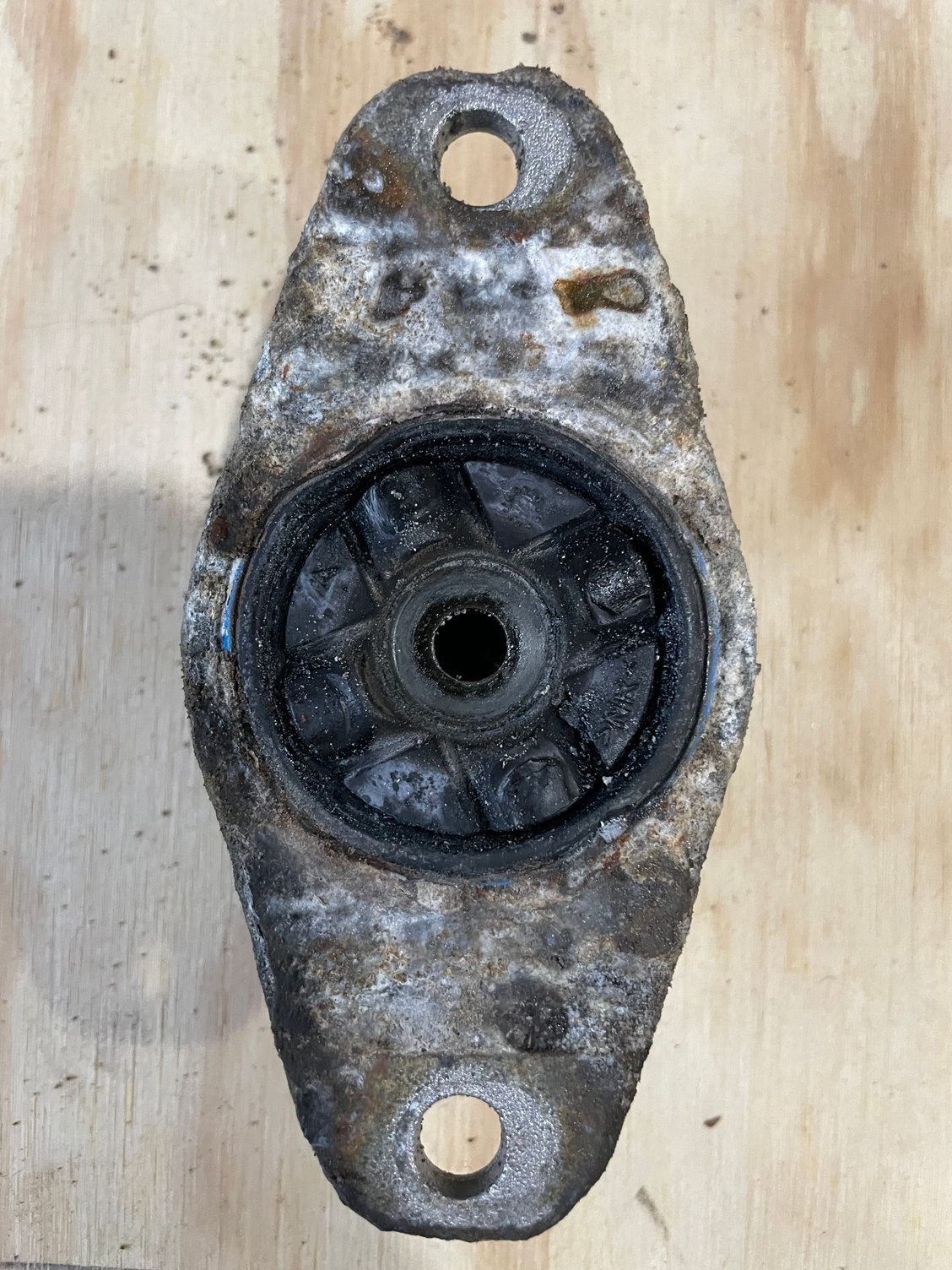

This isn't the first incident of this happening, as it has actually happened on other Mazdas that use this design of rear mount. We pulled the rear shocks on our CX-5 after 61k miles and the mount was fine, however the car isn't exposed to any salt as we don't get snow here in Southern California. I've attached a picture of the stock mount below from our car for reference:
I was able to find the mount itself (Non OE Mazda) for sale, but the fact that Mazda is packaging them as a set together with dampers together suggests that Mazda wants to have them both changed at the same time. What mileage did you have the shocks changed before they broke?
