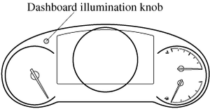

In some countries, you can change the speed units between km/h and mph by pressing the dashboard illumination ****, the speed units in the instrument cluster will change. It works for my 2020 but not sure if this works for the 2024 Japan market models.
