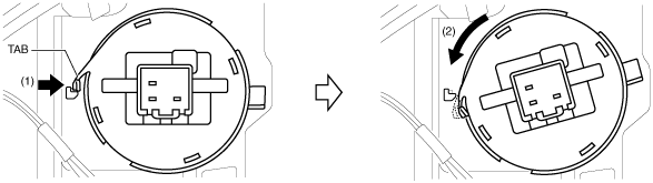

I located the resistor behind the glovebox but can't seem to get it out. From my replacement, it looks like it should turn slightly counterclockwise and pull out. I have not been able to find any details on line and I don't want to bust it. Any feedback would be appreciated.
Old Dec 30, 2016 | 09:04 PM
Posts: 7,849
Using my mind reading powers, you are replacing the MOS-FET, have a look at this diagram.
( METAL OXIDE SEMICONDUCTOR FIELD EFFECT TRANSISTOR )
Rotate the power MOS FET (2) while pressing the tab (1).
Old Dec 30, 2016 | 10:41 PM
Carl Newhouse's Avatar
Joined: Dec 2016
From: Miami
You are correct and this is exactly what I was looking for. I suspected it was counterclockwise but wanted to be sure as it's very difficult to turn. Thanks!
