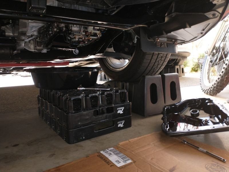

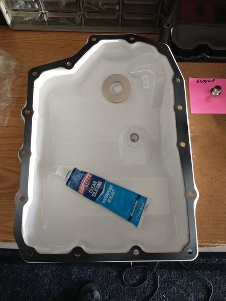

If there is no record of a transmission fluid & filter change, I would recommend doing that as well. That way all of them will have the same mileage. Change intervals are similar for all of them as well. That one takes 8 qt / 2 gallons. I bought a filter from RockAuto that was a perfect match, but the included gasket was for something else. I used this to seal the pan. Follow the instructions carefully, don't overdo it.
