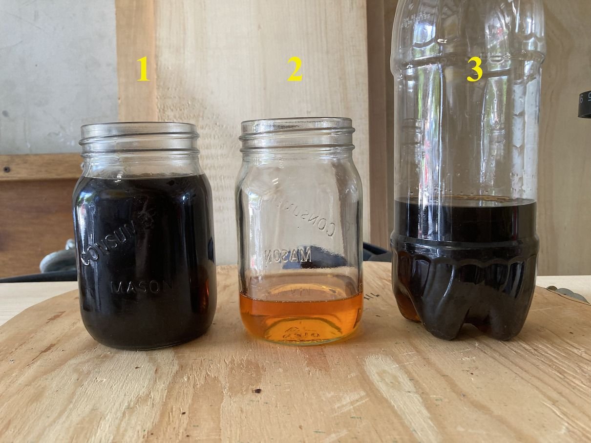

Follow up to my 2020 CX-5, 2.5L, non-turbo, AWD:
Changed my rear diff and front transfer case fluids today. Quick, easy, enjoyable job. About 45 minutes. Rear was very easy as did not have to raise vehicle or remove any splash guards and annoying push clips.
Took this pic of the fluid to share. Change done at 84,700 km = 53K miles. First change I believe as I just purchased the vehicle in April.
#1: used front fluid
#2: sample of fresh 75W85 Redline hypoid fluid
#3: used rear fluid
Observations:
  • used fluid appeared quite "cooked", when pouring it appeared as darkened foggy pale orange. Glad I changed it. I plan to change every 30K miles = 48K kms going forward.
  • Only rear drain plug had a magnet. Some, not much metallic residue which was nice to see.
  • All plugs loosened easily.
  • Rear fill washer was missing. (yes, I replaced all 4 with new washers)
