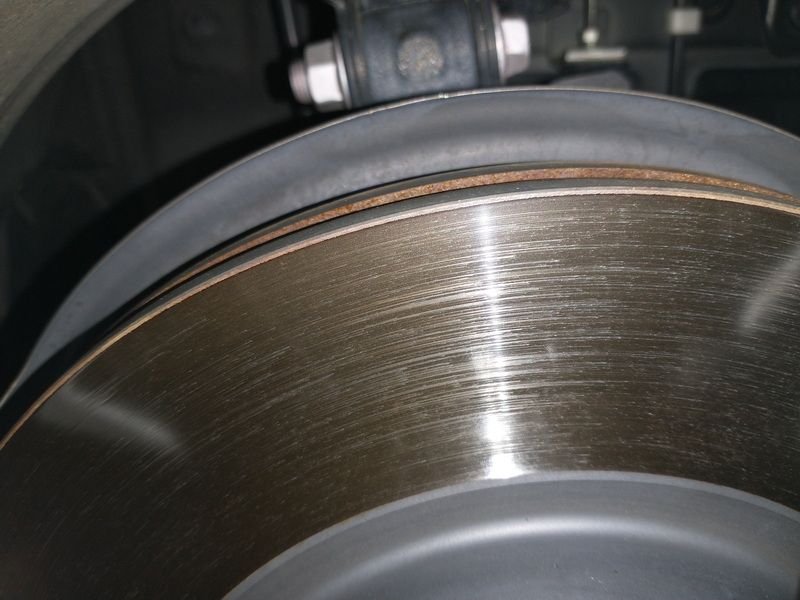

Originally Posted by 1SG Retired
Are you sure it's your front brakes? Attachment 8936 If this is the issue, I'd personally stay away from the fix. Probably not your issue, but thought it could possibly be worth mentioning.
Yeah I'm sure, it's very apparent it's coming from the front if you're in the vehicle.

As for you picture?????????????? auh ok so it is a rotor no brake pad and no indication from your responses that there is anything possibly in the chassis or suspension that may account for some concerns? Is this how you tell a doctor when something is wrong with you... "I just feel something is wrong doc"! lol
As for your picture??????I can do that as well .
It does not show the pads it does not give any clue of a problem.
