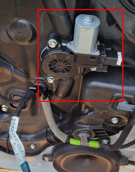

By power window regulator you mean this:
which it appears to be a simple 3 bolt and single power connector removal?

You will need to remove the door panel to access the window motor (which appears you did and it is in the red lined box in your picture) and manually test the unit. But it does sound like a bad power motor. Easy DIY replacement service about 2 DIY hours mostly common tools.
This model is regulator and motor as a unit replacement
