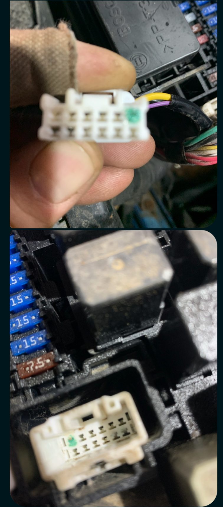

Brought my car into my mechanic(who is actually family) and he finally found the issue after he replaced the oil pan. The mazda dealership did mention to clean the area where the frame is grounded around the front bumper which they did. The car refused to stay again, he asked that I bring the other key since it was not detecting it (well the start button was blinking orange). Other jeu sous titre sans. Ran a meter to see what was happening with voltage to the transmission and first reading was 3 volts. They looked for a wiring diagram and took another reading and now it was 8 volts. Something is a miss here. They took off the ciné-club and found this. I've cleaned up the tranny works like a charm.
