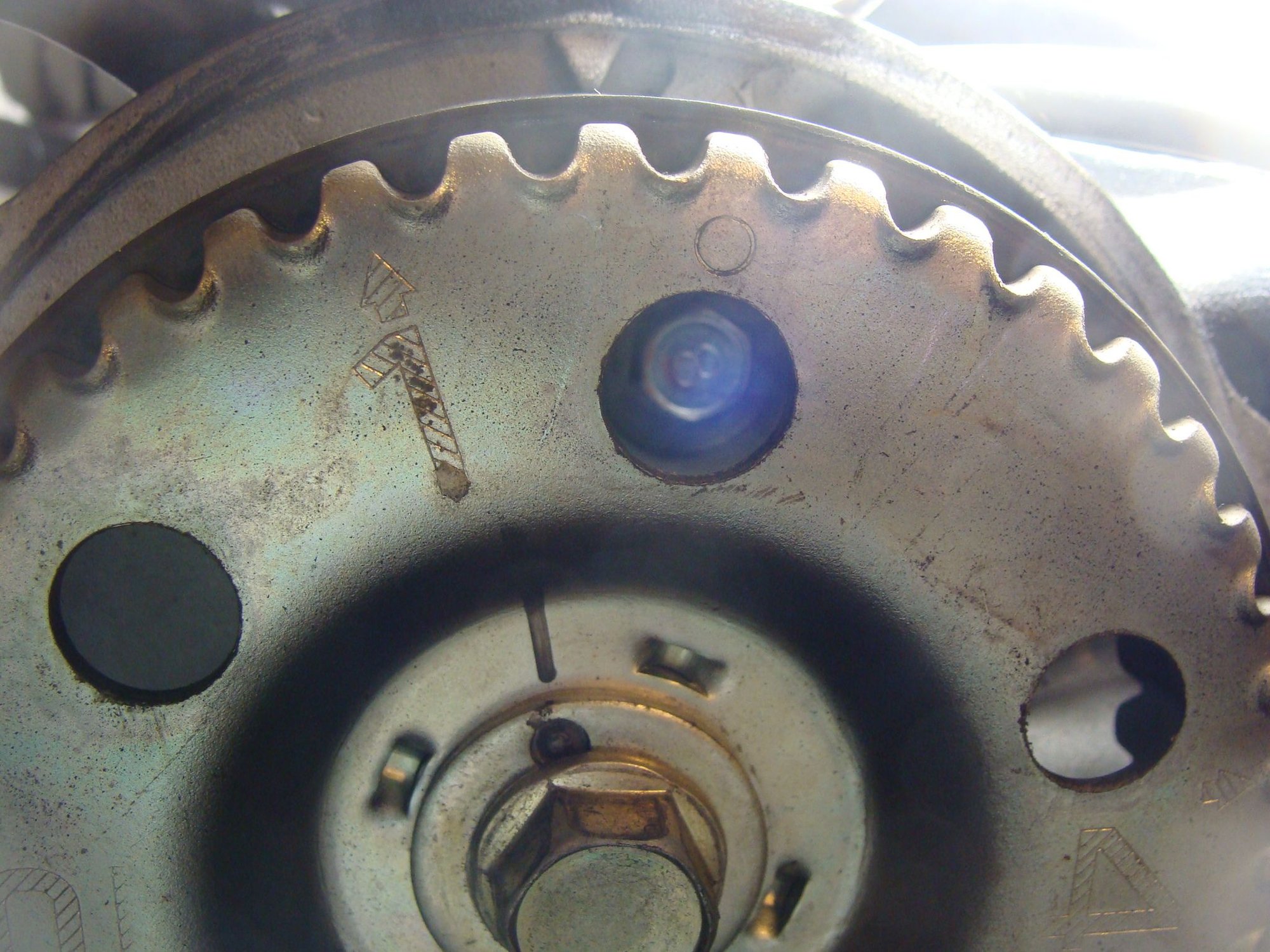

Could be camshaft seal like you said, same part number as the crankshaft seal.
On mine, I substituted a metric allen bolt so in the future I could remove through one of the holes in the camshaft pulley, instead of this.

Yeah The allen bolt sounds like a good idea.
