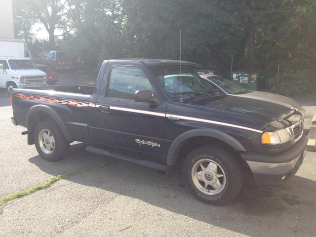

Hello,
I just picked up a 99 B2500 troy lee edition. It has 182k and runs fantastic. the only issue is its squeeky as hell. turning, going over bumps etc.
Ive taken a look underneath and found the ball joint boots all torn. I suspect this is the issue. So ive ordered 4 new ball joints, new sway bar bushings and links.
anyone have any issues like this? any opinions on this model?
I figured i couldnt go wrong for $800.
thanks!
tom

first off. i have no idea who troy lee is! the interwebs tell me he's some motorcross designer. mazda put out a troy lee model to attract the motorcross/snowboarder types. all i know is those flames are terrible and the interior seats have bad tribal tattoos on them. haha

my first project was to remove those damn flames!

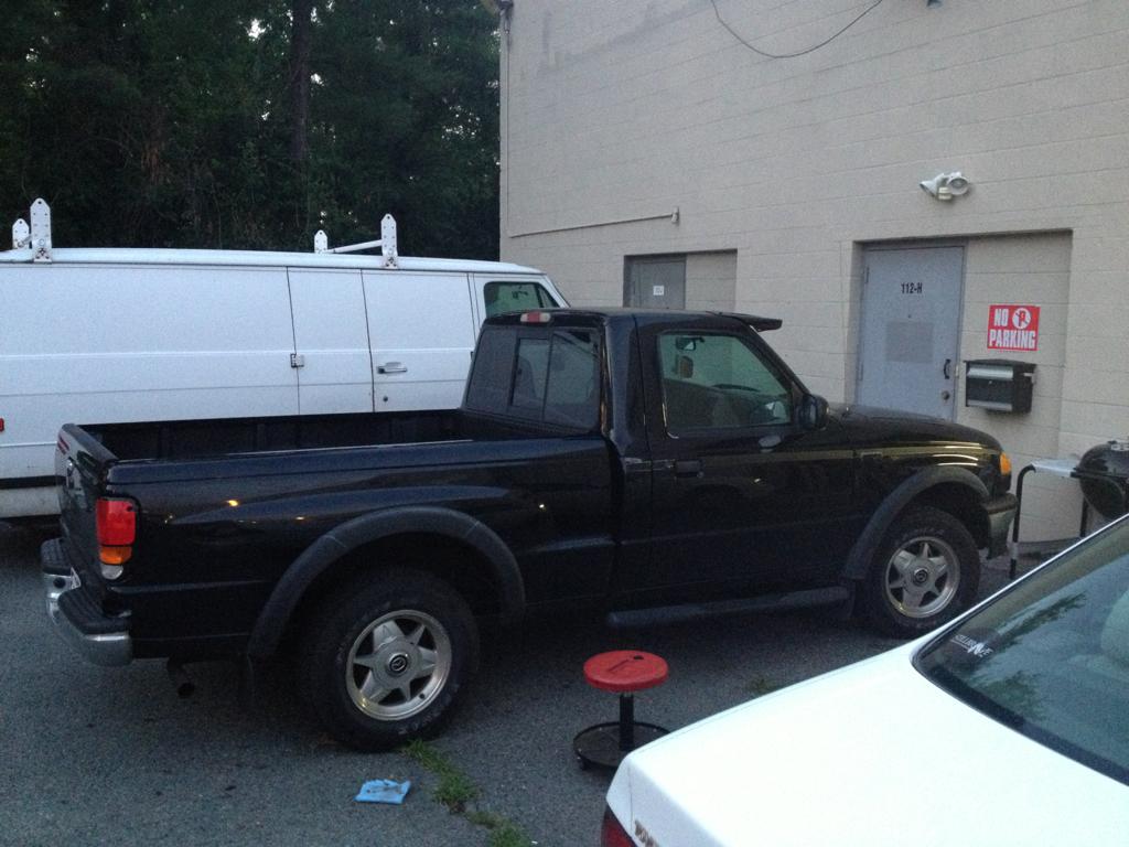

QUOTE-- De-flamed and de-badged.
I liked the Flames!
I would have kept them on the bed part!

99 Troy Lee
