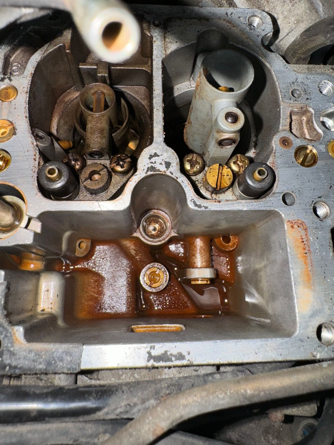

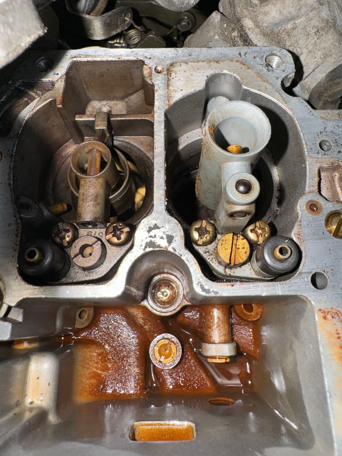

Ok so this is what I’m dealing with first time working on a carburetor engine. I did check the float and it’s hold pressure.

Yep. I knew it was going to be nasty inside. Get some carb cleaner in the aerosol spray cans and clean it out the best that you can.......paper towels help soak up the gunk in the bowl after spraying in there. Once the inside is cleaned up, remove the jets and plugs with a blade screwdriver and clean those on the inside. You may want to draw a simple diagram of the inside of the carb, and take plenty of pictures disassembling the carb items, so you can look back at them to help in the reassembly. Watch out for small steel or aluminum check ***** inside the passages before blowing them out!
