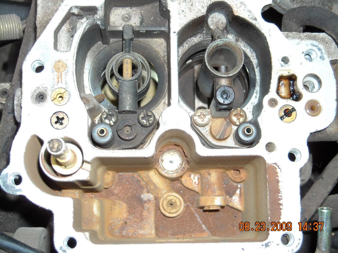

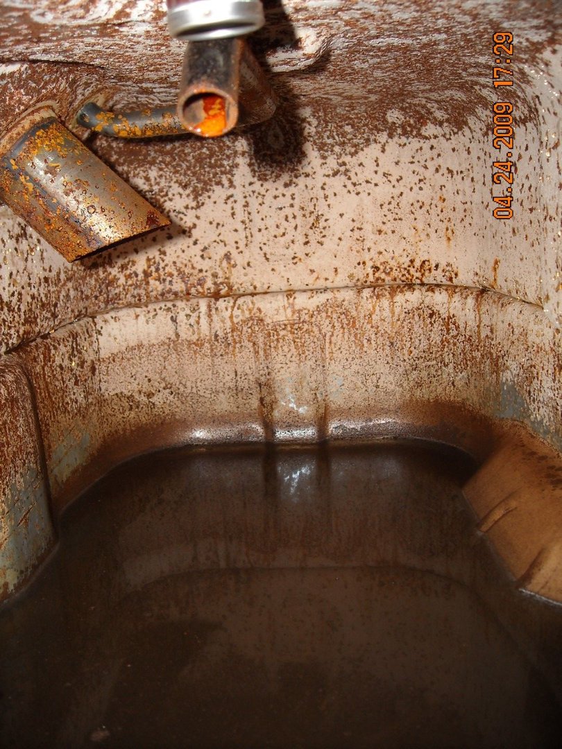

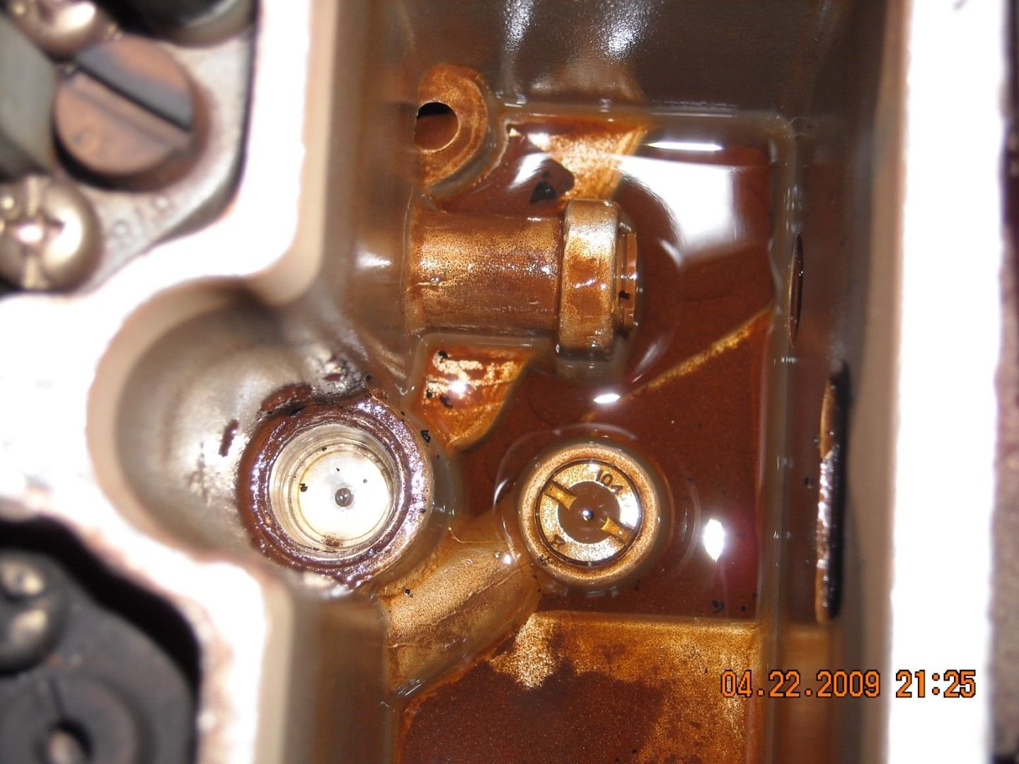

Definitely to buy a Weber carb from Redline. The stock carb is very hard to rebuild, mainly because it has a solenoid inside of it that can give you troubles if it gets dirty inside of it......you can definitely try to clean it first, since it won't cost you anything.....that is what I would do. You might get lucky......once you pull the top of the carb off, you will see how nasty the bowl is......just clean it all the best that you can, blow out any passages that you can see with compressed air (about 20-25 lbs is all you need), and see if you can get it working good again. If not, go the Weber route if there is no emission testing in your area.
It has always amazed me how much trash (mainly rust particles I'm assuming) can get by the paper fuel filter! Here are some pics of a stock B2200 carb that I worked on.......the gas tank was definitely rusty!
