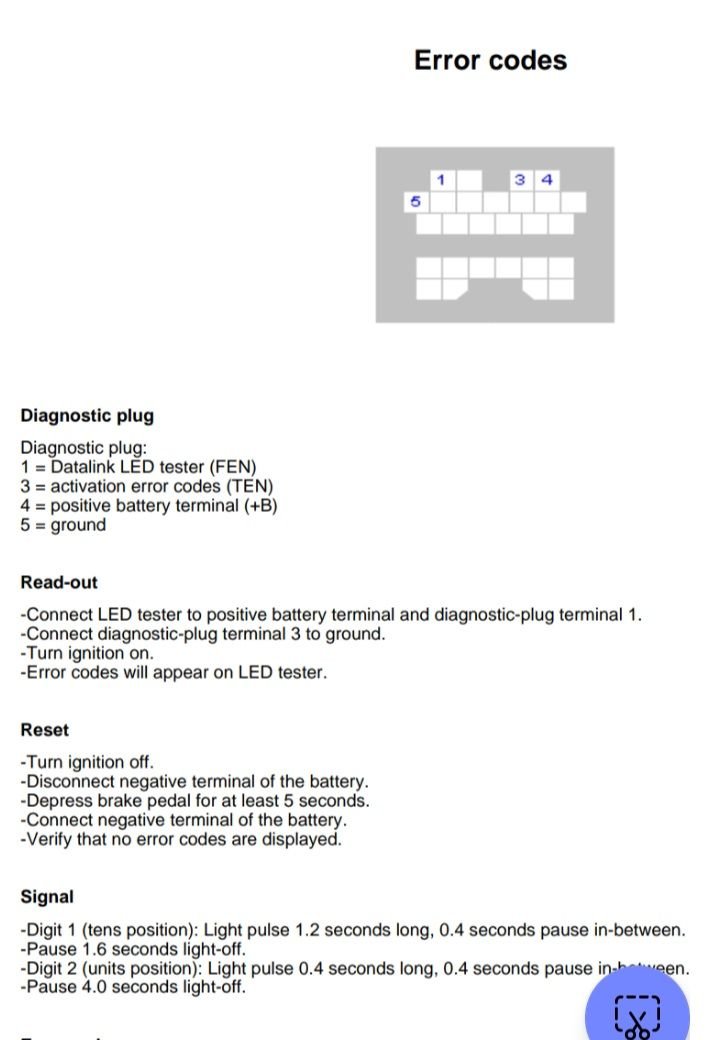

I am sorry to hear you have difficulty finding the diagnostic port. Extract from Mazda 323 1.6i b6 EGI manual just to confirm the procedure should you locate the port. I have used this method many times on various pre 1994 models.

Nice to read that the info provided has come from a Mazda manual and not just heresay.I have found in my reference material the same info posted by Riaan34 applying to later models and the interesting thing is they are OBD2 codes.
The big issue is locating the diagnostic socket. Theres probably a few scenarios why it's not there but without it will make it difficult. I have wiring diagrams but they may not be applicable to US market vehicles.

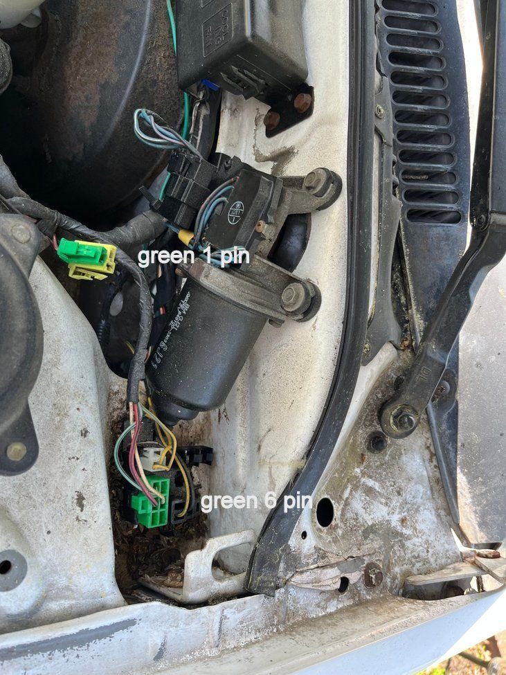

Diagnostic socket? Everything was in your first picture which I used.
Step 1: ground green 1 pin. Can do simply with a wire with stripped ends. One in green socket and one around strut stud.
Step 2: follow pdf file: https://www.mazdaforum.com/forum/att...851d1686551838
Shows how to connect pins A and B if you want to put an LED light here. One can also read inside on the instrument panel.
