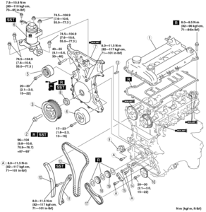

Old Mar 26, 2018 | 04:35 AM
Part #16 is the Oil Pump drive.

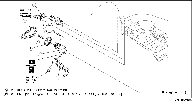

Old Mar 26, 2018 | 04:38 AM
Oil pump
