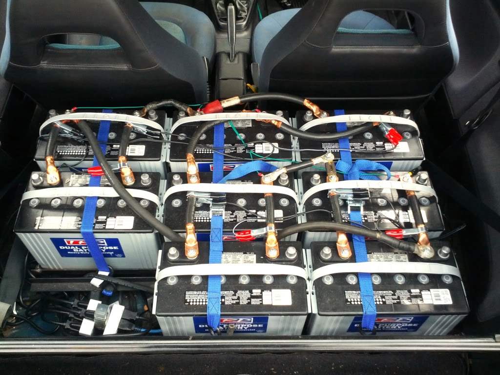

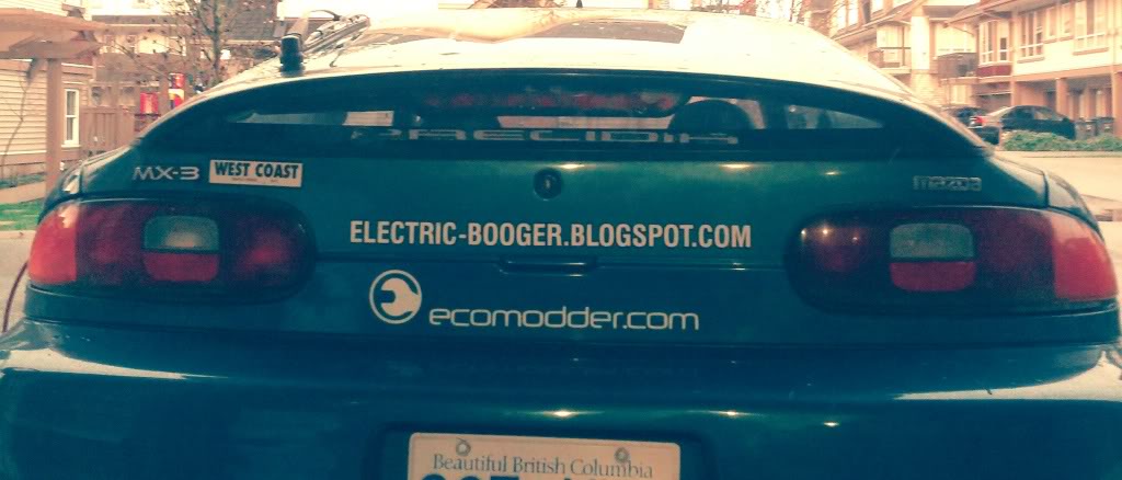

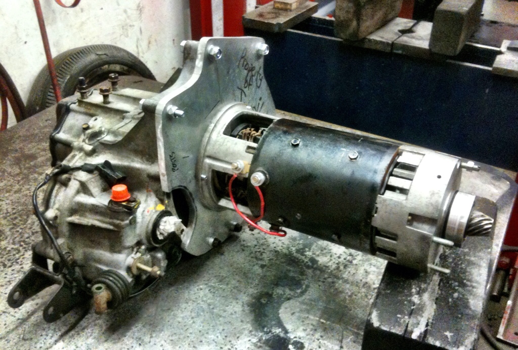

I have owned this car for about a year now and finally decided to join a Mazda forum. I recently finished converting it into an EV.
May I present: The Elecrtric Booger.
Size:  183.8 KBName:  IMG_20130107_162601.jpg
Motor: Prestolite forklift DC motor
Batteries: 12 X 12V 92aH AGM
Voltage: 72V
Controller 1: Alltrax 7245 (Armature)
Controller 2: Kelly 72100 (Field)
Chargers: 6 X 12V eCIty 240W PWM
Heater: blow dryer heater coils
Top speed: 90 km/h
Range: 30 km
Acceleration: sort of almost adequate....
