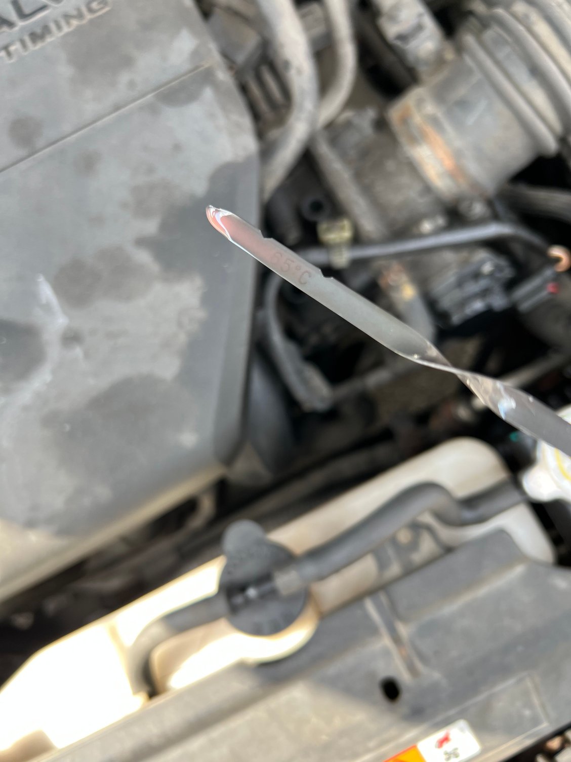

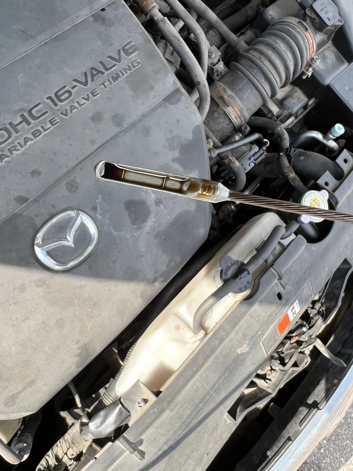

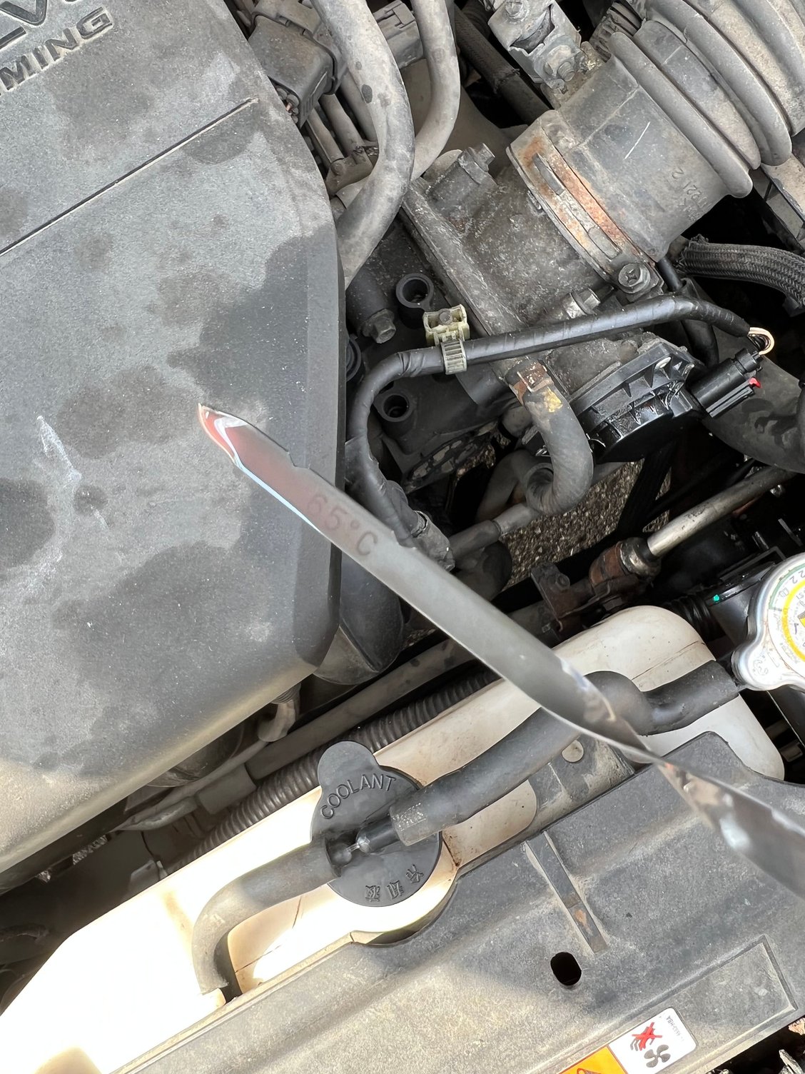

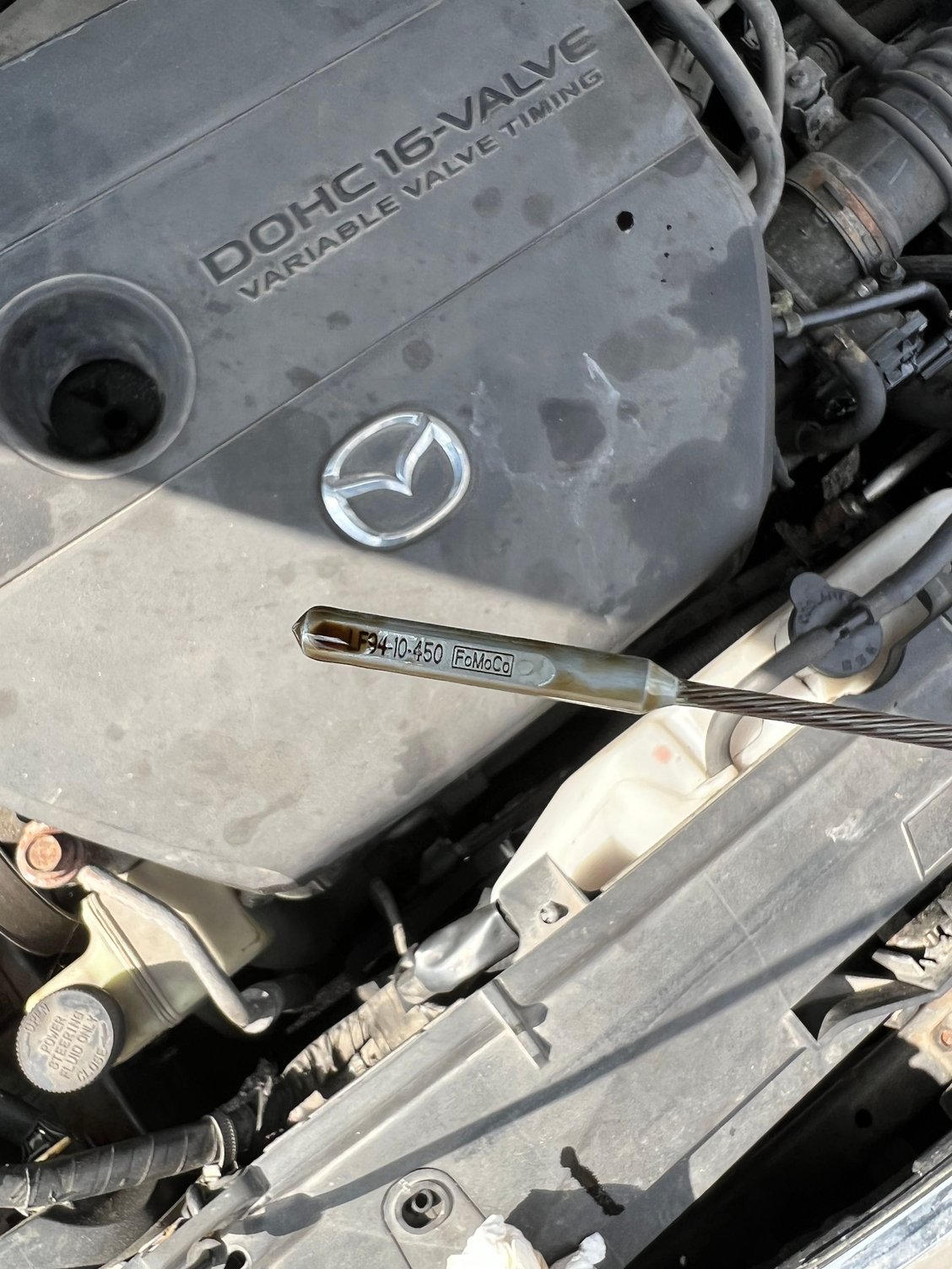

The problem is my cars transmission light isn’t engaging (I’ll try to grease up the cable that is underneath the car), it is engaging, car doesn’t budge, but the sound is rather worrying, everytime there’s this specific motor-like sound ZZZZZZZZ underneath the vehicle, it doesn’t happen with other gears. Also I’ve photographed some of my fluids after letting the car stand for the night. Oil had been changed half a year ago, but it seems rather low to me. The engine heats up really fast, probably doesn’t even take 5 minutes of idle and up to 3.5k driving for it to be right in the middle, doesn’t overheat, but is too worrying. Also my transmission dipstick after the night of standing showed almost a full 65 celsius mark “fillage” even though the car was cold. Car shakes really bad, might be the mounts, and you mostly feel it while idling, the door mounts don’t have any vibration to them, the hood has some. The car jerks when in 1st and 2nd. Also there is smoke out of the exhaust (might be condensation) sometimes after driving, even though the car is already warm. Now that I told you my worries, here is the backstory.

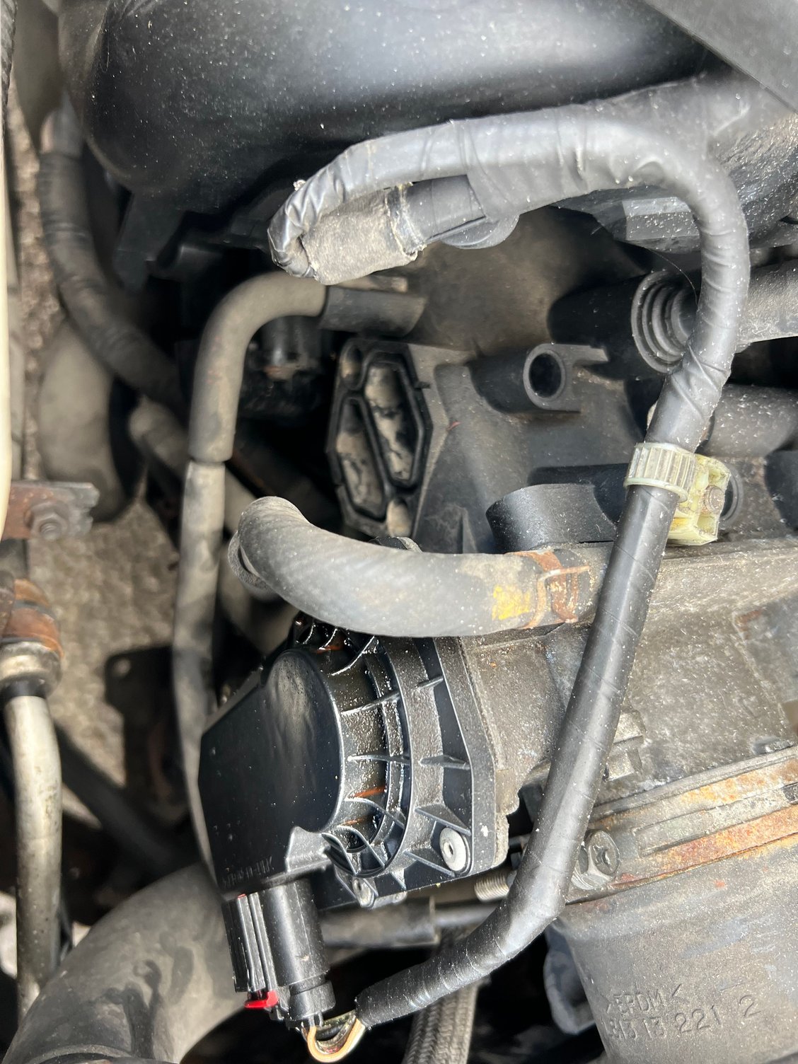

P.S. There is bunch of residue or oil (not sure) on the engines plastic (shown in photo), car absolutely stinks of oil through every single imagineable hole in the car, and I think through the A.C. too. Also how many fans should be running on the radiator? One turns on sometimes when it feels like helping the A.C.

I reckon the cable shouldn’t be twisted like that, also the plastic thing next to it looks like its leaking, and it has been the same dirty, fluidy since 6 months.
