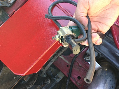

What is this?
Old May 14, 2013 | 06:33 AM
Posts: 7,847
Was it down beside the air filter housing?
Looks like the solenoid for the air filter cold air flap.
If you remove it you run the risk of the engine warning light coming on.
If you remove the factory air box you must keep it plumbed in, and where it normally plugs into the airflap block this tube off with a M6 bolt.

Ya it was beside the intake, when I bought the car it came with a CAI and that part was tucked into the fender...any idea how to fix
Old May 14, 2013 | 07:01 AM
Posts: 7,847
Do as I said.
