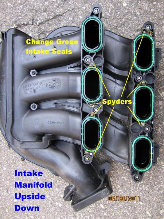

I've been re-reading your thread and on other forum. You have had misfires and lean codes. You have 105,000 miles on it.
You have changed 3 ignition coils and no spark plugs (although idiot flipper on other forum thought you changed them all and both---he skims alot but he is generally good).
I would have changed all the coils and all the spark plugs (with that mileage). What idiot changes coils without spark plugs is beyond me. One of the coils may have caused a misfire, but the spark plug associated with it might not be up to snuff and clogged. However, these causing a lean code is a puzzle.
You said you had a exhaust leak on your pre-cat?----did this get fixed? I am not as confident as you in your exhaust being fixed (welding an old pre-cat). However, with that mileage especially, a bad pre-cat can and does cause a mis-fire (Mazda recommends them changed @ 100,000 miles but they should last longer with proper spark). Misfires will screw up your pre-cats: Reasons For A Converter Failure . What is your current cel code? I believe you have changed one O2 sensor---- hopefully it was the first one on the exhaust stream.
The EGR is not suppose to kick in @ idle, however it does over 1,200 rpm or so. If you are hearing something there, get some one to take it apart and clean it (again it should be cleaned due to mileage).
Your tensioner could be shot at your mileage. If you replace the tensioner, change the belt.
You have got a lot of things going on with high mileage. I don't really know what your solution is, but a few things need tending. Did you check your accordian tube on intake for cracks? A bad brake booster will cause a lean code (it leaks internally and is hard to detect---you have to actually wait until once or twice you lose power brakes).
When changing plugs or coils on rear bank closest to firewall, intake plenum must be removed, I hope he changed the 6 green intake plenum seals--see pic (like this: OES Genuine W0133-1639826 Intake Plenum Gasket | Auto Parts Warehouse )along with the rubber seal between the throttle body and intake manifold (like this: Mahle W0133-1807640 Throttle Body Gasket | Auto Parts Warehouse .
Attached Thumbnails Running Lean P0145 + P0141, already spent 0 trying to fix-intakemanifold3off.jpg
