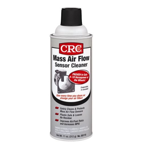

Did you reset the computer after the exhaust fix by unhooking the negative terminal so the computer could re-learn the changed parameters of the exhaust? If not, do it.
Secondly, check for vaccuum leaks, including accordian intake hose.
P0171 and P0174 lean codes are common faults on many Ford, including the 3.0L Duratec. The lean fuel condition is often caused by a dirty mass airflow sensor, vacuum leaks in the intake manifold or vacuum connections, or a defective DPFE sensor. The fix may require cleaning or replacing the MAF sensor, or using a smoke machine to find elusive vacuum leaks in the intake plumbing. (FROM: http://www.underhoodservice.com/Arti...0l_engine.aspx under Heading Driveability Issues).
When cleaning MAF sensor remove it, spray liberally, and wave your arm around to dry it. Before removing it, remove negative terminal from battery. When MAF is dry, re-install it, then re-hook up battery before starting. Let it idle for 10 minutes before driving. drive it for 1 week.
Attached Thumbnails Running Lean P0145 + P0141, already spent 0 trying to fix-maf-cleaner.jpg
