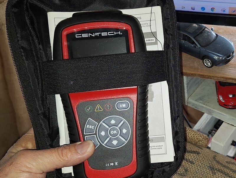

I actually carry with me at all times and even at the shop to do a quick assessment of a customer's issue CenTech Scanner.
My other scanner (Snap-on Solus +) I have close to 4 grand invested in it so that only comes out when absolutely needed.
There are other brands that are simple and reliable and also NO ABS.... that's another subject but I don't think a DIY should be attempting to service ABS systems. LOL
