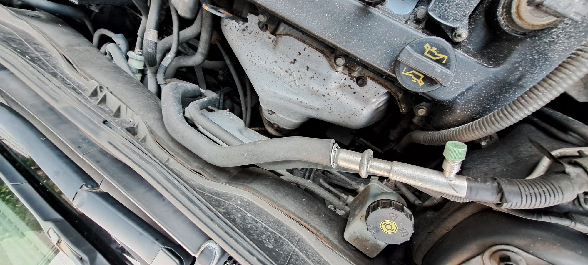

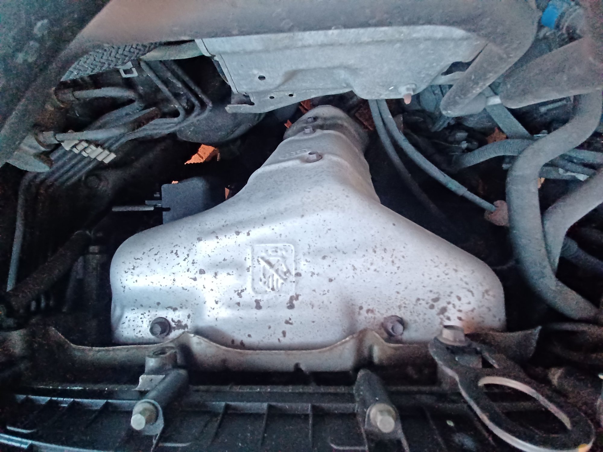

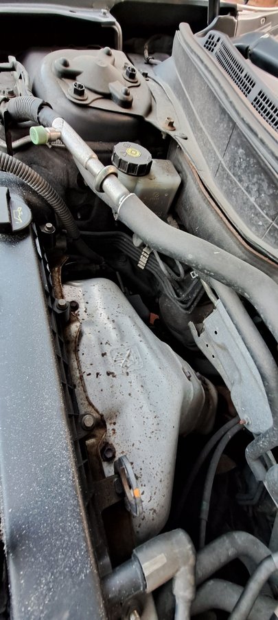

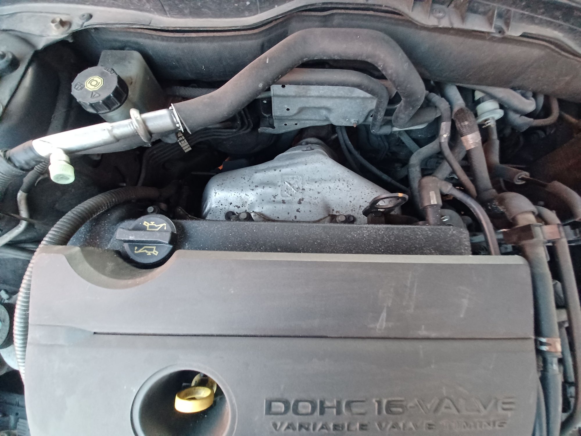

I need to change oxygen sensors in my Mazda 6 as I'm getting all symptoms of faulty oxygen sensors. I ordered both of them - upstream and downstream one. I quickly located downstream sensor looking at videos on youtube, but in the location where I should have upstream sensor, there is nothing !
Please see pictures below from the engine bay, can anyone help me finding the upstream sensor ?
Or is it possible that someone removed it ?

Its very close to the head of the engine just slightly down from the beginning of the exhaust manifold.

Yes, and that is what I described. The HO2 bank 1 needs to be at are very close to the primary or front CAT. The one you mention which is Bank 2 is post CAT and basically read the oxygen after the CAT.
BTW the DTC having to do with HO2 is one of the most often misdiagnosed parts from DIY that often jump to the conclusion based on YouTube info or non professional based service manuals part replaced before confirming they are the cause of the DTC. Often times when replacing them with new HO@ the problem originally was not solved and unless the NEW parts were first verified as not having any problem as in a good part will add to the already unresolved issue.
Your pictures are not showing the hard to reach area where the primary Bank 1 HO2 is, re-read my first response again and go look with a flash light if anything else jack the front up get under the Mazda and look for the HO2 wire harness and follow it to the HO2 by the CAT!

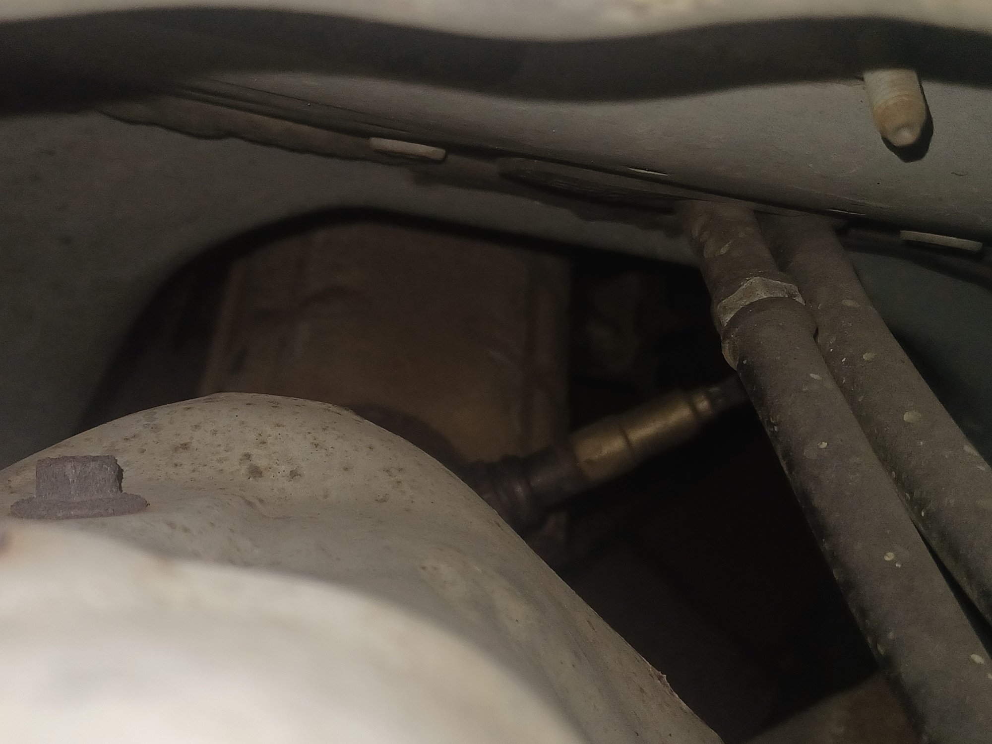

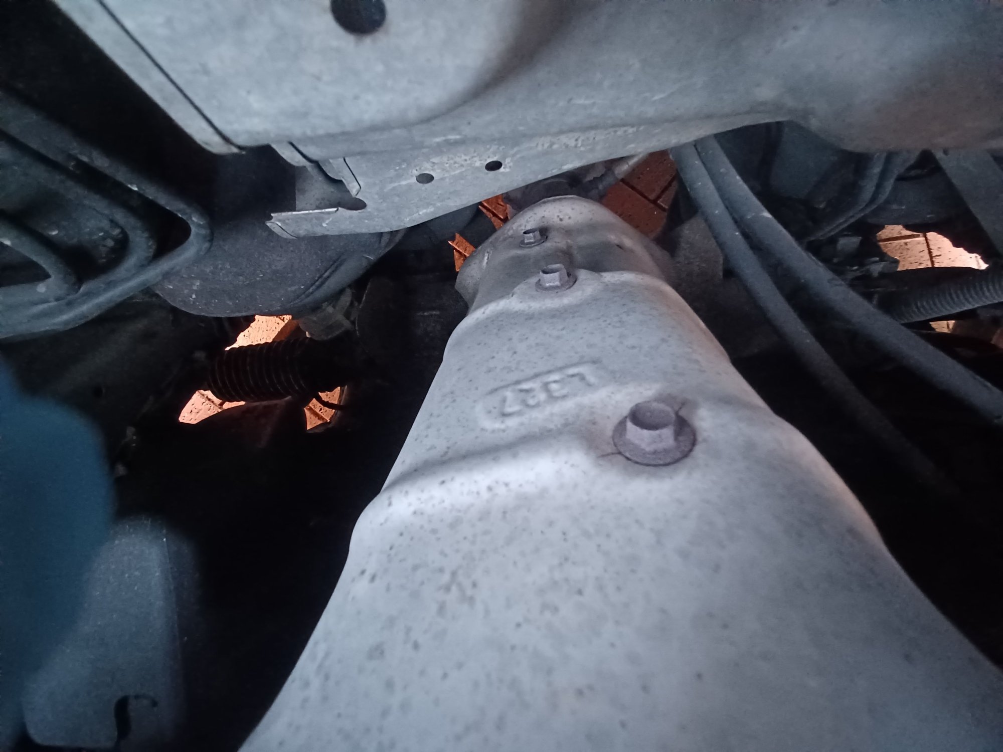

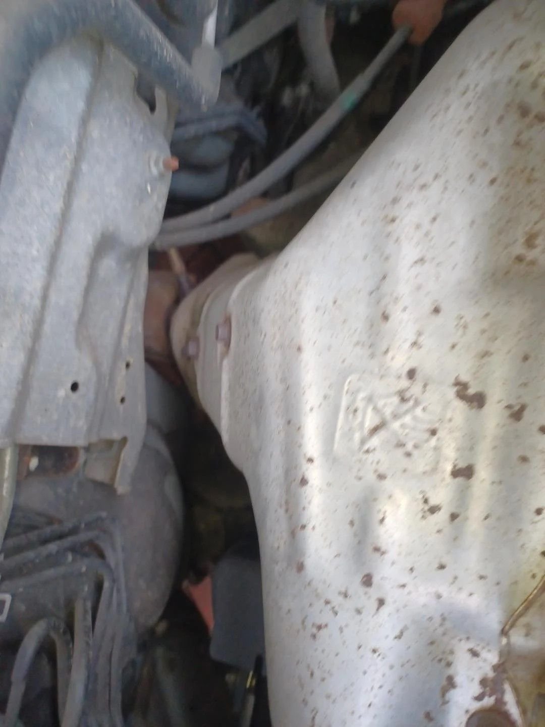

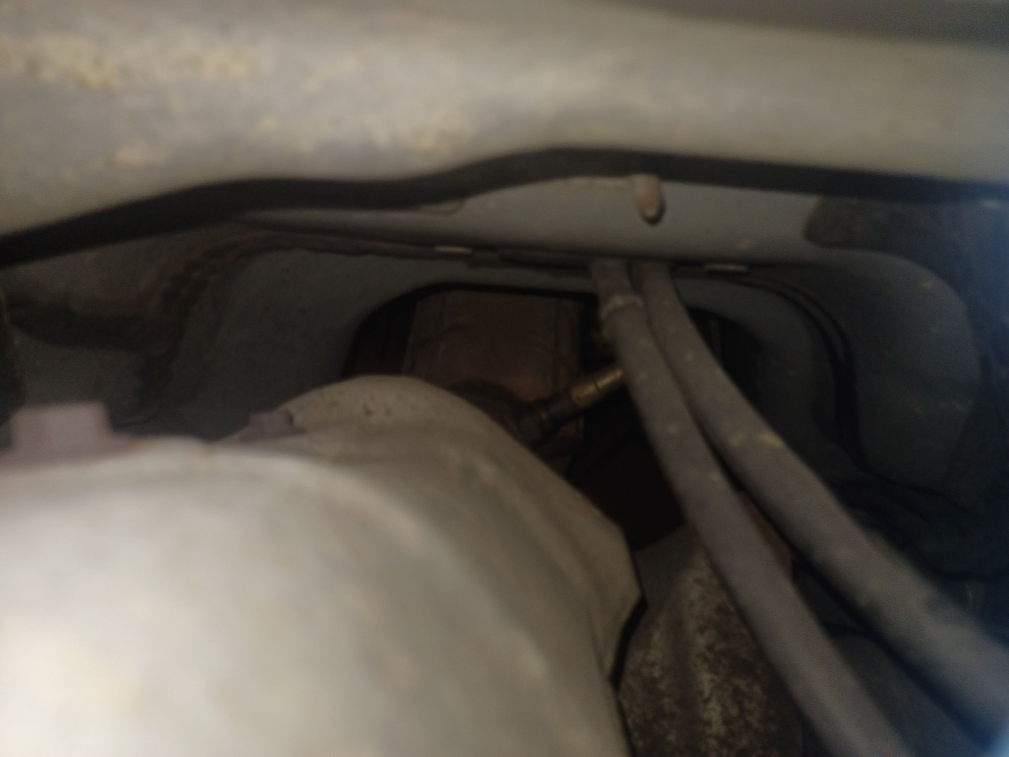

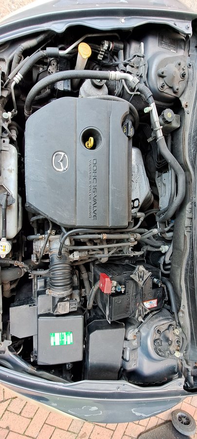

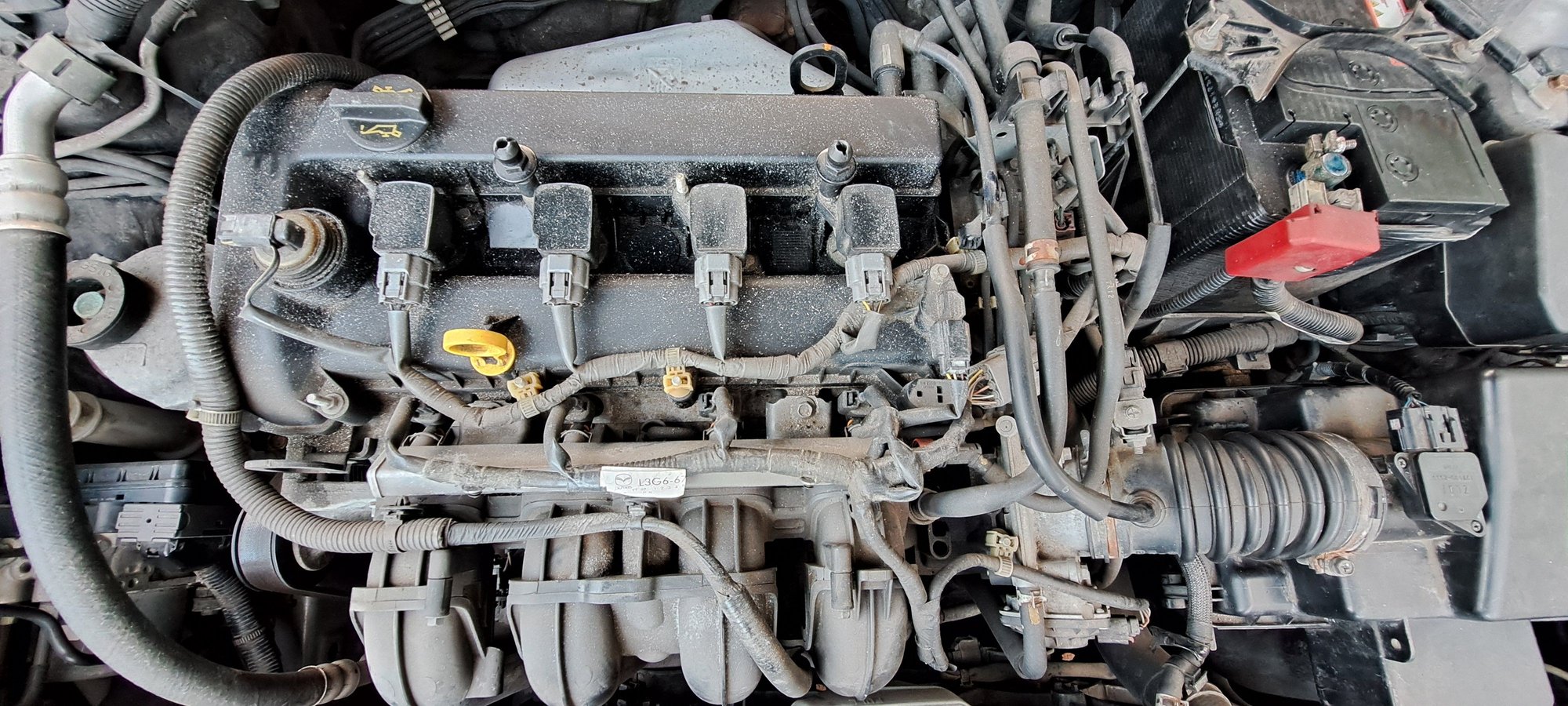

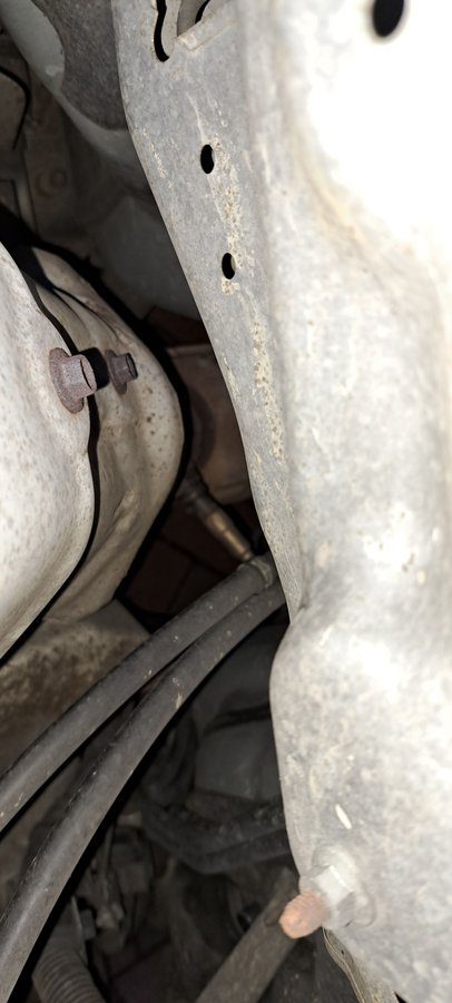

I re-read your message, and I went back to check the car.
I took more pics following, starting from the top.
I followed it down to the sensor which is short downstream sensor.
I'm still unable to find the upstream bank sensor.

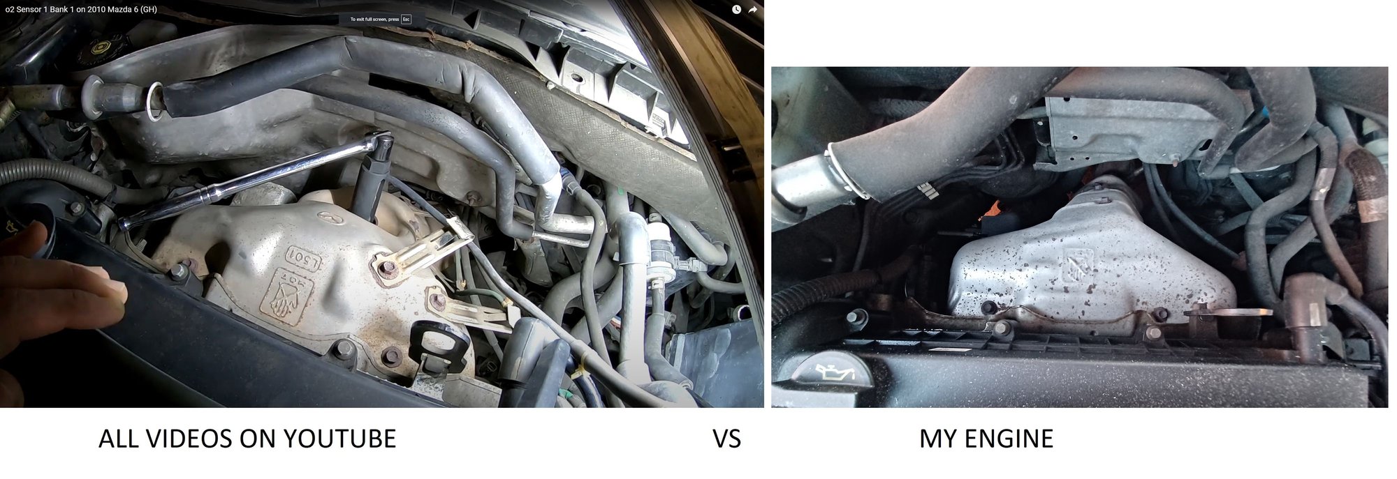

I even made comparison pic for you, using videos from Youtube of same MZR GH Mazda 6, please see below comparison, I don't have anything where the upstream sensor should be.
I tried to find that connector on top and follow it, however I'm unable to find that connector.
I jacked up the car, and all I found is a whole in exhaust close to downstream bank sensor, I have to fix that.

First disregard my "BANK" usage for wording it can confuse many and technically not for a 4 cylinder.
HOWEVER your forward or upstream sensor (HO2 or O2) will be in front of the CAT plain and simple.
If you are getting a DTC specially for the upstream HO2/O2 then you have one. Plain and simple. You can also verify this information by using your diagnostic scanner connected to the diagnostic connector and looking for the ho2/o2 sensor information. If it shows one or the other N/A then you don't have that sensor.
I am sorry, but the USA version of your Mazda has both I don't have UK or Mazda marketed for outside the US and Canada what they did or did not have for standard emission controls. Technically speaking in USA your Mazda would likely be a grey market vehicle and therefore difficult to register and license here so service information for some platforms is not complete for all service information.
The very last picture in your previous response appears to have a sensor in the back ground?
