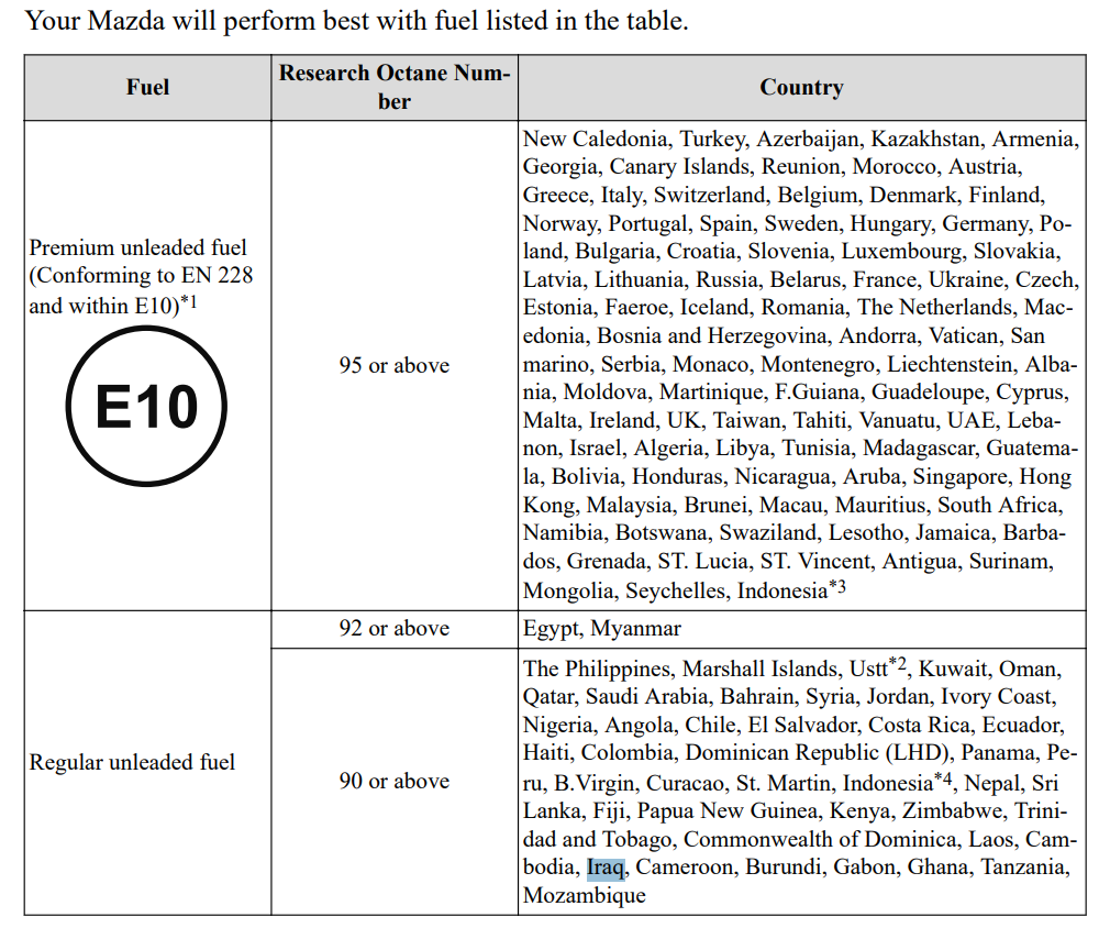

I just check the owner manual of the American and Middle East version:
*Both of them mention that the car use compression ratio of 13
*The spark plug are same: PE5R-18-110 or PE5S-18-110
Do a poor oil and oil filter effect the engine to make detonation?
