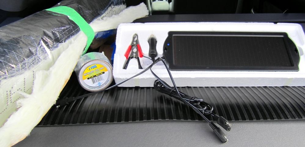

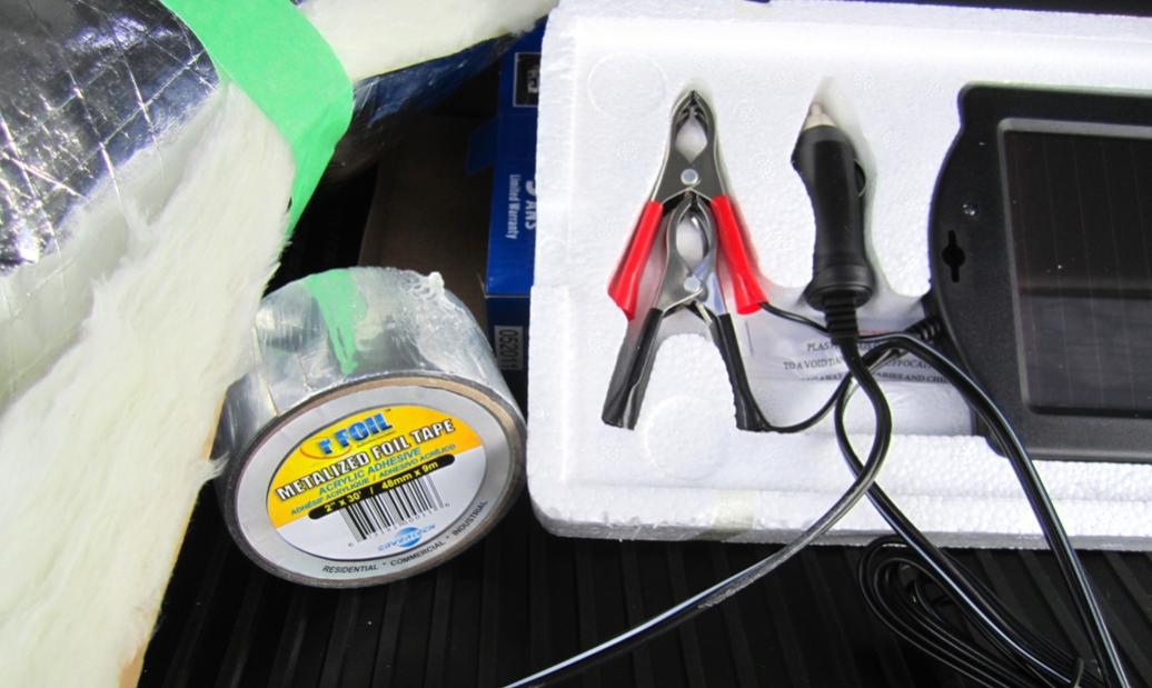

Found some better insulation today (I guess Karl was on my mind). This insulation requires no gluing or painting. It is 1.5" thick with an aluminum backing good for up to 250 degrees (see pic). The alum will be on outside joined together with special alum foil tape---should be tight against battery. $6 insulation, $6 alum foil tape.
Rubber rigged black floor will go on bottom of battery (in pic).
Solar panel 1.8 watt. 125 ma/hr. 5 inches X 13.75 inches. It will be mounted on top of dash in front of steering wheel area on tilted area with velcro. Wired direct to a constant live fuse in panel. It does come with a cigarette lighter adapter or alligator clips. We will not use either but special spade connectors that wrap around a fuse hopefully. Our cigarette lighter is not live, it only works with key on.
Installed Battery insulation today. While I had battery out, I ran a pair of wires through the firewall for the solar panel (wires sitting on top of battery). Pics attached. There was 2 SMALL AIR HOLES at bottom of battery tray. I put a piece of black rubber on bottom of battery tray to block all holes (keep from hot air getting in).

Figured out where solar panel will go. I originally wanted it on top of dash in front of steering wheel but you could see the relection in windshield---FAIL. I have decided to attach it to the passenger side visor. With the blue tint on top of windshield I had to glue it to visor with only 2" overlap so solar panel would come down below blue tint. I managed to get the visor off----it has a lighted mirror. The plug right there was a pain in the *** to remove as I had to remove all weatherstrip around plug to push screwdriver in slot to release plug. The vanity is live to the battery. I may hook wires up to it, although i have wires already thru firewall. This will get decided Tuesday. Gluing more on backside tomorrow (brought visor inside). Slow process but making progress. Cleaned cabin air filter also (behind glove box).
