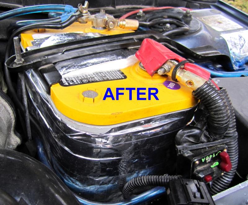

Added more insulation to front main battery under hold down (pic).

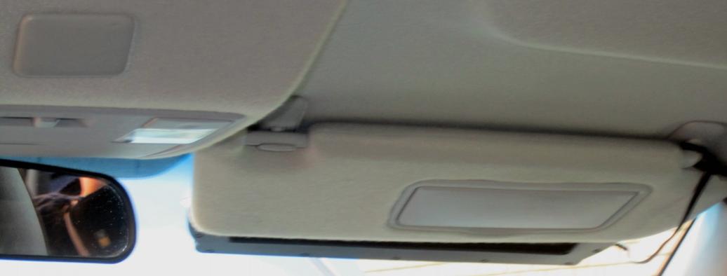

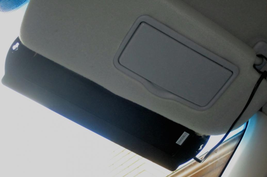

1.8 Watt = 125 ma Solar Panel charger finally installed on passenger side visor. It is wired directly to Battery. Ran wire down pillar. Removed Glove Box and fed wire through middle to join to wire I fed thru firewall last week when I removed my battery to insulate it.
I glued solar panel to visor. Overlap is between 1.5" and 2". You must cut thru material and rough surface up on visor and solar panel. Was leary of bolting it. It is suction cupped to windshield. No worries of it flying around. I can fold it back but never will--I would have liked it 1/2" closer to driver side.
It is on continously-----it will never overcharge battery due to my constant parasitic draw of 120 ma.

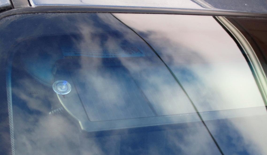

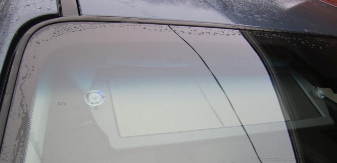

The blue tint strip across top windshield actually covers 1/4 of the solar panel, however depending on angle of sun it should still get great charge. This charger works even in low light conditions (says right on box). It is good up to -40 degrees celsius, other end 80 degrees celsius.
It is a "Blue Planet" Solar Panel I bought from Canadian Tire retail $30, got it on sale for $16: Blue Planet Solar Panel, 1.8W | Canadian Tire

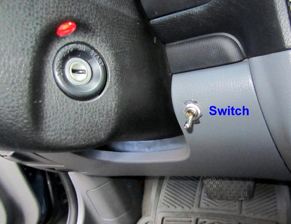

I re-read the instruction manual/brochure for the Solar Panel. Even thow it has a protective diode that does not allow reversing of electricity, they recommend that you Unplug the Solar Panel while Driving (That SUCKS). So I installed a toggle switch (see pic). It would be stupid to install a lighted switch in this situation.
I had a switch in there before, but the new switch would not push through. I found there is a second plastic panel behind (which did have some cutouts but not big enough) of which I had to remove some more material with a pair of side cutters. The top panel comes off easily---pull at bottom then top (at area around switch----not necessary to remove whole panel to other side of steering wheel). It can be bent back to see panel underneath and enough room to cut it.
So now before I start car i turn switch off, and when i shut car off, i turn switch on so Solar Panel can charge.
There is a blue light flasing on the Solar Panel. It is an indicator light telling you the solar panel is working---it was flashing as i removed it from the box-----it was not wired up. This indicator light is not telling you it is wired up or disconnected, but rather just working.
UPDATE : Briefly talked to my mechanic and he said it is just a safety precaution, it will not damage solar panel if you accidentally don't turn switch off while starting or driving car. He suggested a RELAY. I don't know how a relay would work because the relay would have to be hooked up to the ignition and when ignition is on it is suppose to disconnect the solar panel circuit which is directly hooked up to battery and vice versa when ignition turned off.
ANY THOUGHTS?

Hey, Noggin:
There are different types of relays. You are thinking of a relay were a current is used to turn on a devise. There are relays that do the opposite. They switch off a devise. Look at #87a here:
1954 Chevy Pickup | Understanding Relays
SPDT | The Single Pole Double Throw Relay has a fifth contact: 5. #87a -- Always goes to a Secondary Electrical Device ... usually not employed unless you have a second device that you want turned on whenever the first device (#87) is turned off.
So your first devise is the ignition and when you turn that off your second devise, the solar charger, is turned on.

Default AWESOME--RELAY is the ANSWER
Hey, Noggin:
I just phoned my mechanic again after your post (he's open til 6:30pm). I asked him will the relay turn the solar panel off. His response was YES, connect it to 87A. Awesome Tanprotege (and great link of installation of relay), I'll get this done Tuesday. Today when i went in to start my car i forgot to turn it off, when i got home i forgot to turn it on (went back outside). This solves these issues.

Had to replace suction cups on Solar Panel as the ones that came with kit were small and couldn't handle the tension in the heat. Bought 2 larger ones from Fish Store with 2 strands, pushed them thru holes and slid a small piece of steel to keep in it place with some glue. Been on for months already, much better. Battery still great. I guess black silicone would have been a better choice!
