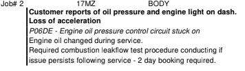

From the service video they provided me, all they mentioned is that they where aware of the "low oil pressure" light, and that the "oil pressure in the car was fine", thats it ?????
"Performed Diesel Engine Oil Data Reset" was on the invoice.
They found other issues that needed "urgent" replacement below that I'm assuming are unrelated to the issue of why the car is breaking down and can be ruled out, however did not inspect the issue that the car was in for besides just checking oil pressure and assuming all is ok? and perhaps just removed the warning light with the tool?

"As per the service report if the light re-appeared we would have to do a combustion leak flow test procedure. It is a two-day repair so we would need to book you with a loan car. I have attached int invoice below for reference. When would suit to book in?"
And when replying with the price this was the response
"The price to carry out a combustion leak test is $1397, This the first step of the diagnostic procedure, this may or may not repair the issue, but we have to start with this and then re-assess."

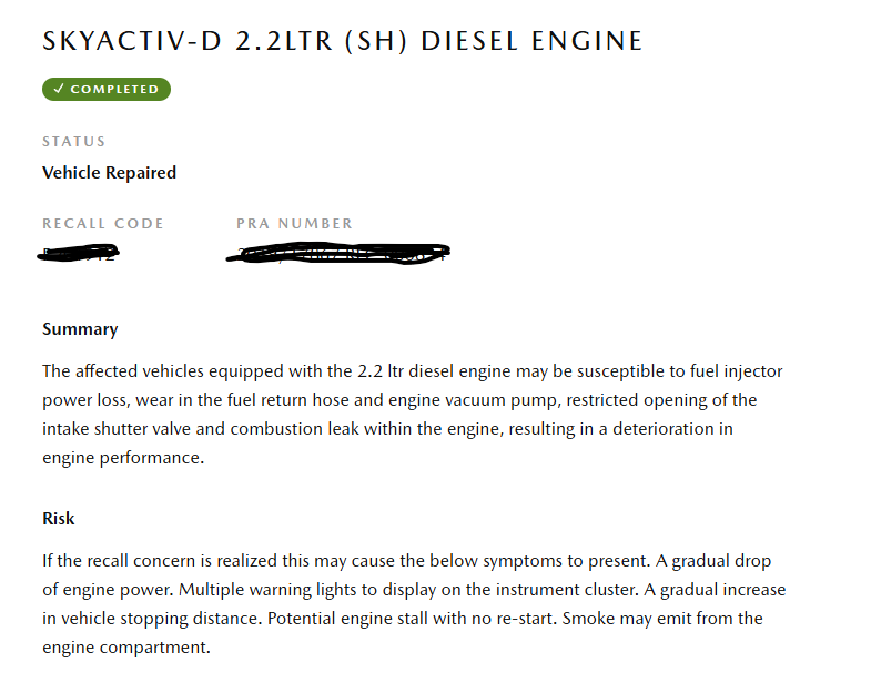

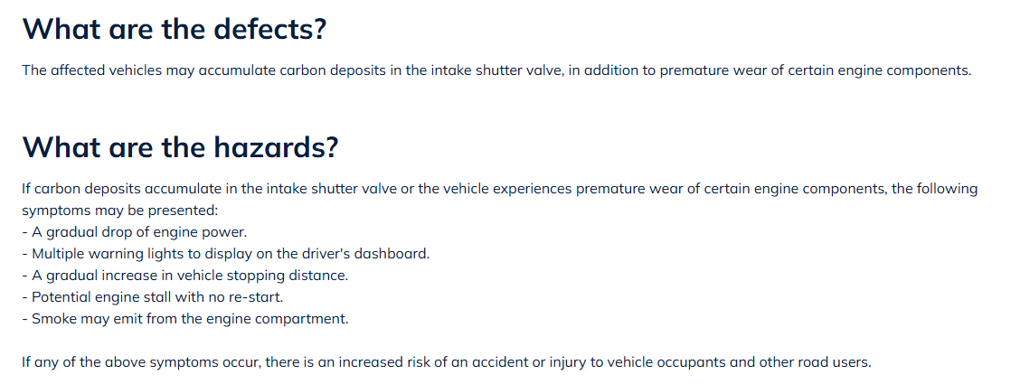

The car was also apart of this recall https://www.vehiclerecalls.gov.au/recalls/rec-000894
I'm unsure if its related, i believe the car has already been recalled and "complete" fixed of whatever the recall issue was above.
I have attached the recall related to the car below and i am wondering if anyone thinks it could still be related to this recall issue. Even if they have claimed to of fixed it at no charge in the past 4 years?
And if so, how do i approach Mazda about the recall even though its been complete if my current Oil pressure/engine/breaking down issue is related to the issue of the recall?

P06DE is often a death code.
Your dealer should know better with the vast history of issues with these SH diesel engines.
The combustion repair is really a band aid repair.
IF it is successful in restoring oil pressure, sell it ASAP to prevent yourself from a large engine replacement bill.
