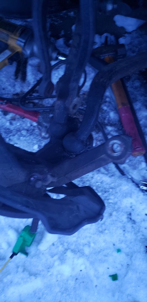

Hello my fellow 6ers
having an issue trying to remove these 2 lower bolts but they won't budge what is that part called is it a hub holder spindle thing I tried pickle fork it bent any advice would be greatly appreciated.
thanks

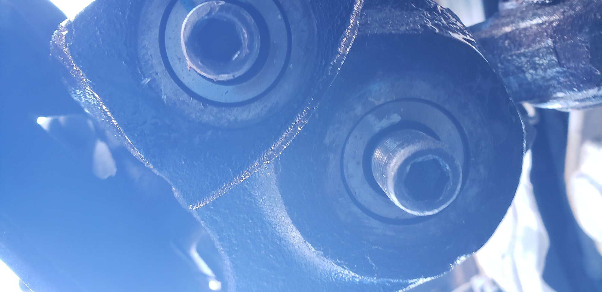

Just checking, you want to remove the two lower control arms from the hub? Once the two 23mm nuts are removed you need a very big hammer and plenty of swinging strength to shock them free.

yes, that the plan be whack at it for sometime now and it's a no go trying to put some penetrating oil in it see if that works. Theres not alot of room to swing my hammer.

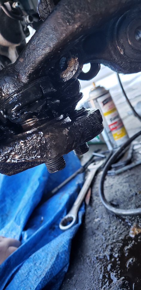

Still whacking it with a sledge hammer to no avail PB buster and still smashing it and it has not moved and yes I removed both nuts on bottom and still no luck. Any advice thanks

are these suppose yo just pop out or are they suppose to unscrew out?!?!? Anyone stressing me out right now i have a jack pushing on the bone up and it still dont budge.

are these suppose to screw out or do they just pop out I have a Jack on the bolt and it's not budging at all any hell would be nice.
