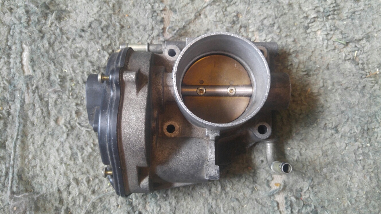

Hello,
Can anyone tell me the part that is connected to the side of the throttle body, it has a connector with 6 pins? Its held in place by 4 bolts.
The part number is vp5n4u93928aa
Any help would be great.

The black piece attached to the throttle body?? I thin someone said KSR Sensor?

That is a "fly by wire" throttle body. It only comes as 1 complete assembly.
The black part isn't meant to be removed. Its the throttle actuator & TPS in one.
