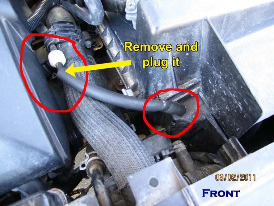

Did you plug the vaccuum line by the white ball! (1st pic)

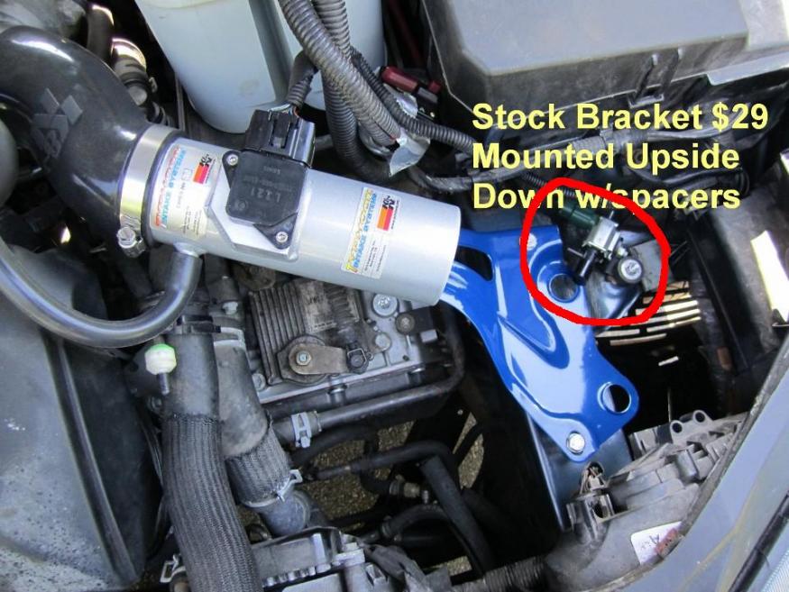

And leave the green solenoid plugged in! (2nd pic)
of course you'll have to disconnect battery again.

Sounds exactly like the EGR is sticking open due to the EGR vacuum dump hose being plugged off from an air box delete. If so, yours would be the 400,000 th one I have seen. Don't plug the vacuum hoses off.
Sorry bud, your wrong, you need to cap off the one by white check valve as i stated.
As per K&N instructions:
(2.3L models only) Remove the vacuum elbow hose from the one-way valve as shown. (Fig. 9)
11. (2.3L models only) Insert the M5 pan head screw into the end of the vacuum elbow hose. (Fig.10)
Here is the pdf instruction sheet:
http://www.knfilters.com/instructions/57-0615_inst.pdf

I don't see your diagram but since when does K&N know more about every Mazda ever made than the factory? Look up EGR vacuum dump. Plug that hose and it holds the EGR open. PERIOD!!!!
On my car that vac line goes straight to intake plenum, however, I personally am not familiar with his vehicle, but it's worth a try as he is getting lean mixture. Diagrams are the attachments.
